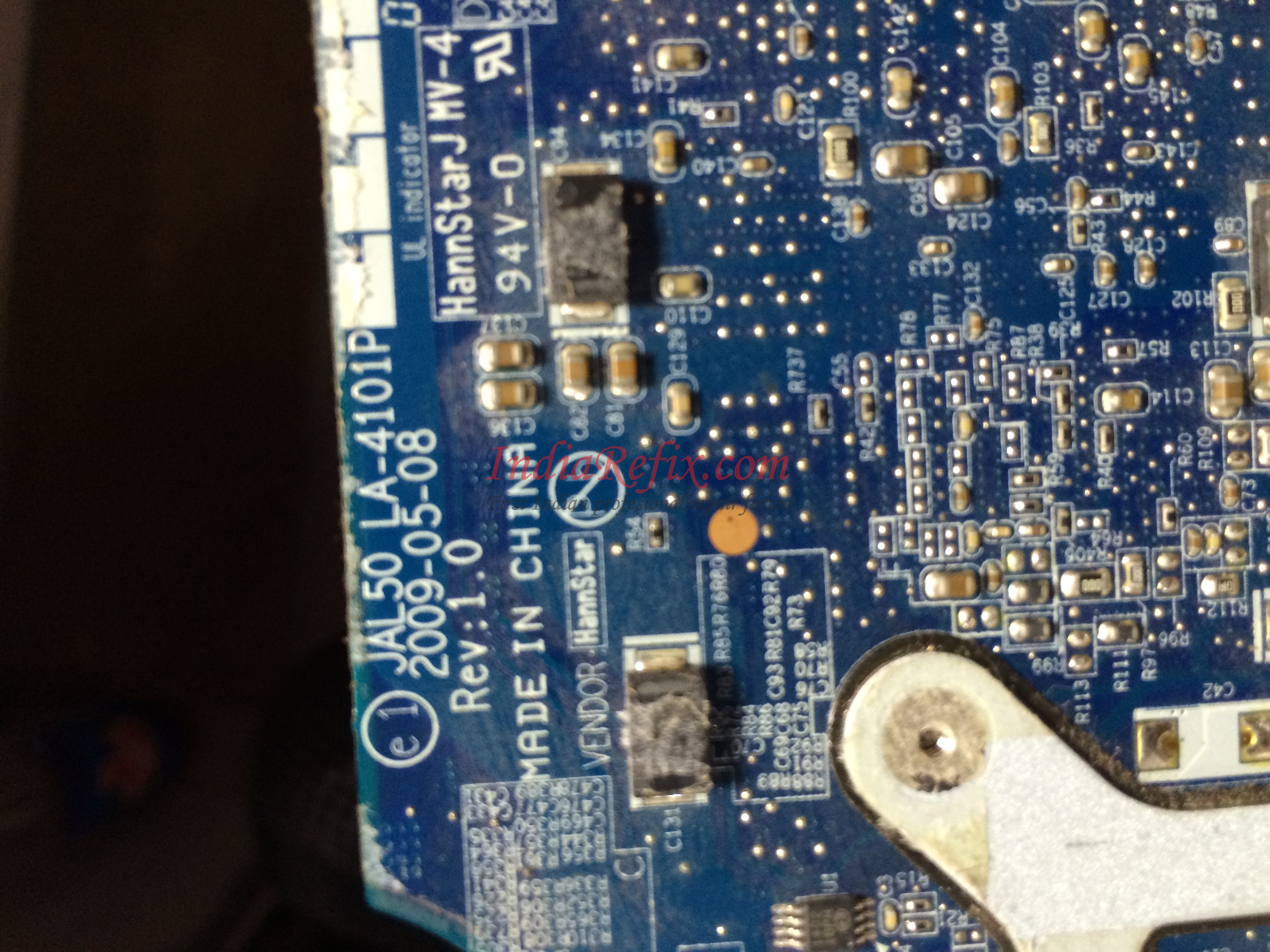

board lal50-la4101p

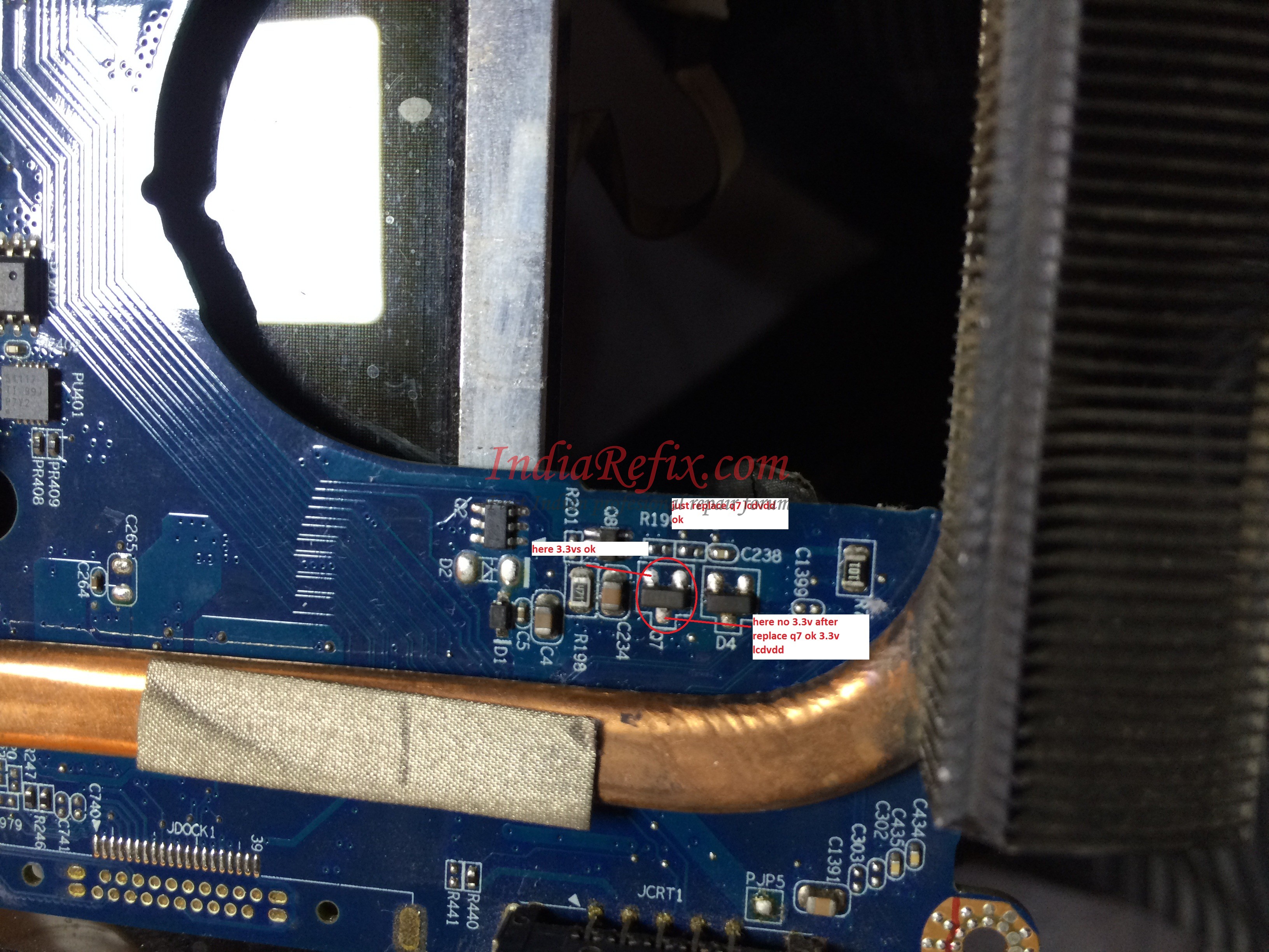

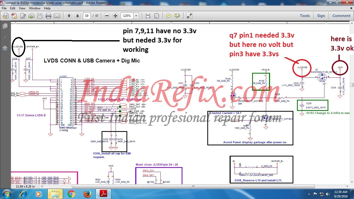

then checked in lvds conector
found 18v ok
but lcdvdd not present pin 7,9,11
which is coming from q7 transitor of pin 1
q7 pin 3 have 3.3vs and pin1 have no volage which is called lcdvdd voltage
lcdvdd voltage is missing
resulation
chane the q7 transitor and checked display working fine
replace the q7 and marking it
board model no
board model no
q7 in schematics
q7 in schematics
