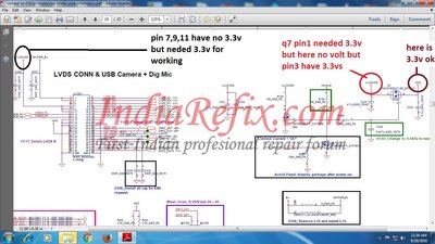

cq 40 power on white display issue

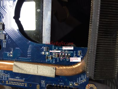

board lal50-la4101p
dignosis
checked in external display ok but internal white display coming
checked with new lcd with cable but same issue
then checked in lvds conector
found 18v ok
but lcdvdd not present pin 7,9,11
which is coming from q7 transitor of pin 1
q7 pin 3 have 3.3vs and pin1 have no volage which is called lcdvdd voltage
lcdvdd voltage is missing
resulation
chane the q7 transitor and checked display working fine
