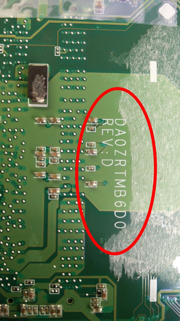

Laptop model :- ACER E5-573TG
PCB Number :- DA0ZRTMB6D0 REV: D
Problem Reported :- No power,

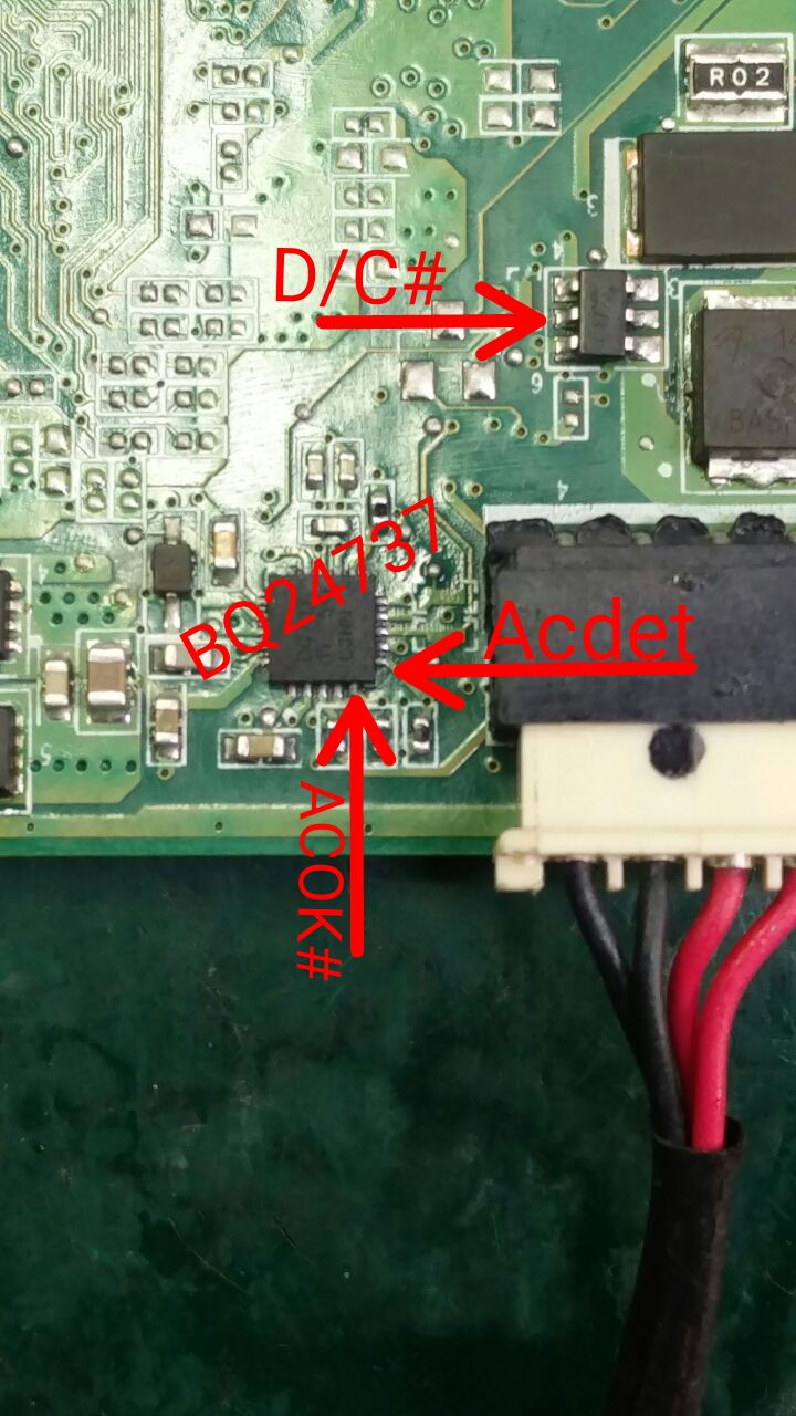

Trun Off and On PSU Power again and try to trigger, again same no power on with single trigger, Now start checking step by step supply's with Continues triggering all supply's are generated but trip , so decide step by step section checking first try to check charging section with battery , when plug battery and trun on PSU , PSU Amps consumption is 0 and first mosfet stop passing Voltage,
so start's checking charging chip requirements,
*Vcc = 17.5 v, Acdet=2.2v
Acok#=3.3v*
Complete parameters are wrong according to circuit, Due to ACOK# high PQ18 Active and get ACIN low so EC Not Detect ACIN on pin 72
Question 💡 why ( PD3) Cross 19.5v to 17.5 v, trun of power remove battery and check Impedance of PD3 output line all are found Ok,
Now Big suspect is PD3 replace PD3 and bingo now PD3 output line voltage =18.9 , Acdet=2.4
Acok# = 0 After ACOK# get Low & ACIN been high 3.3v now set is working ok
All requirements of Charging Chip & EC chip is full fill now ,
