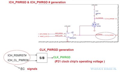

LAPTOP ALL SIGNALS & VOLTAGE (Author Aries)

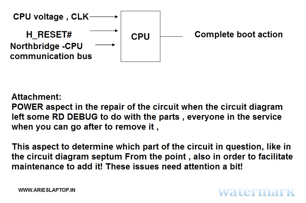

Photos was an converted chinese to english language . some pronounce and adjective mismatch in translator ...

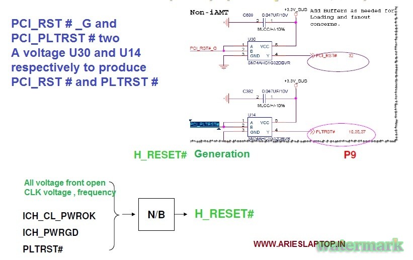

Few More Supply

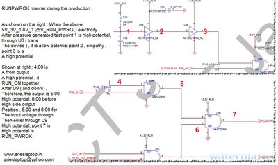

More Detail :) :) :)
