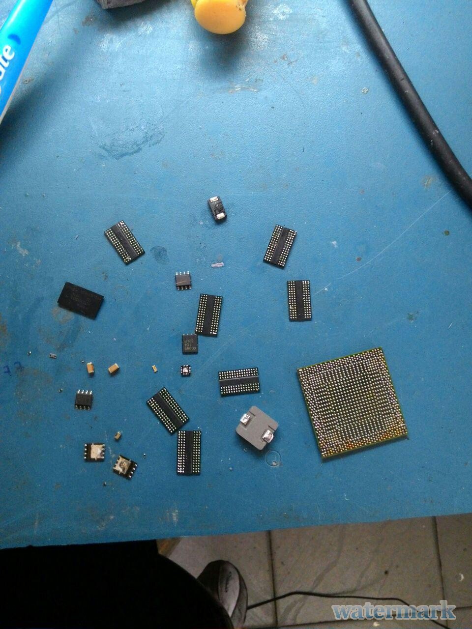

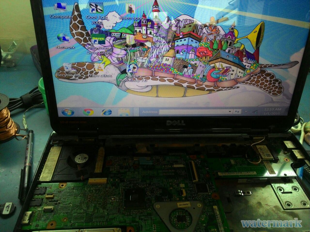

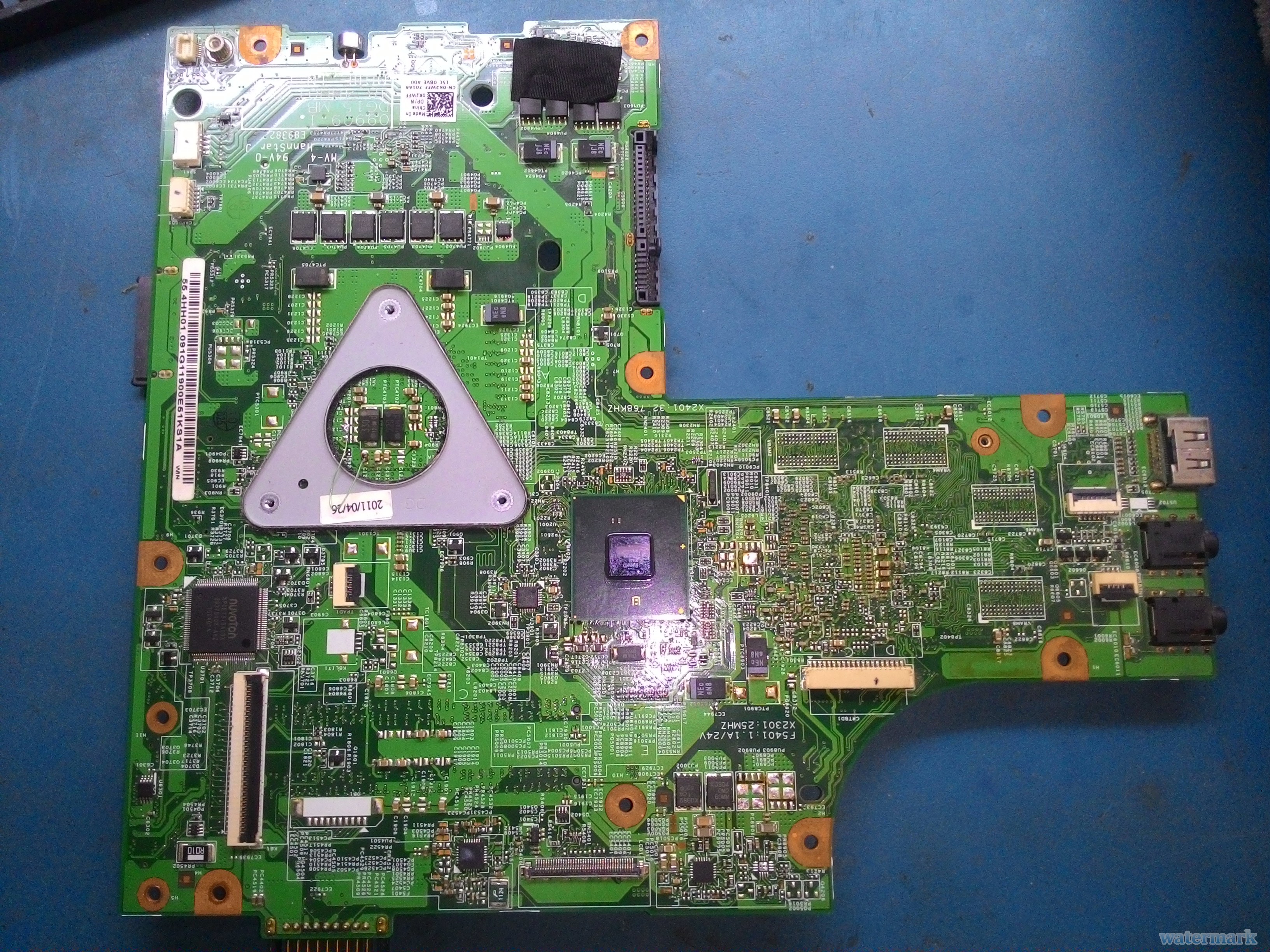

Case Study
Dell N5010
problem no display
checking laptop motherboard bga rebolling other person
I am Graphics to Non Graphics conversion
laptop working fine

good but this pic methode...vga and hdmi not work....
J D Verma
Posts: 119
Joined: Thu Jan 14, 2016 2:15 pm
Location: Ludhiana PUNJAB
Re: Case Study Dell N5010 Graphics to Non Graphics
Post by J D Verma »
YES SIR

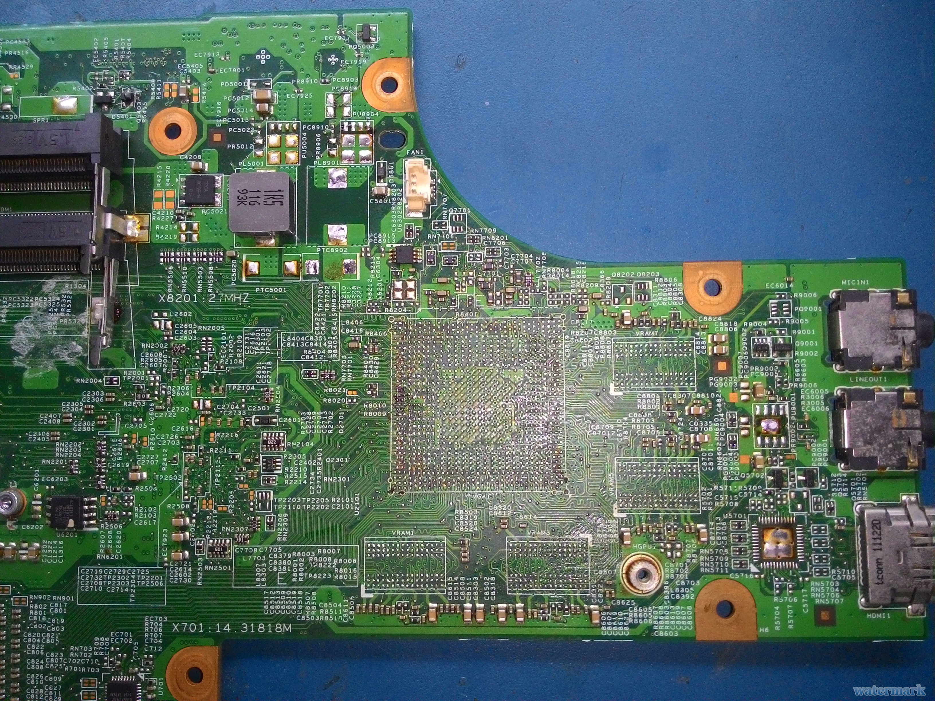

Sir 4 vram near ATI chip this type board plain screen.no data.but 2 vram chip board convertion ok

I need to add one my personal thing that I use max don't I use GPU fx supply to CPU fx make jump from GPU supply to CPU supply my max prob solved nd now I converted around 50 MB on it
