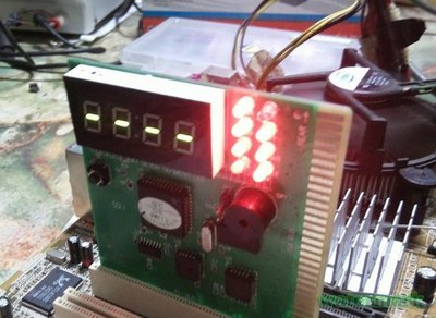

Asus P5GE-TVM/S
Problem: No Display. In Debug card Clock led off and all leds on.

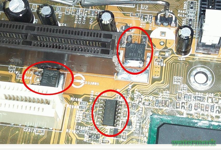

ICH become very hot
Solution: Replace AP9915GH Mosfets and LM324 IC of GMCH Power supply
Debug Card Photo
Components Replaced
