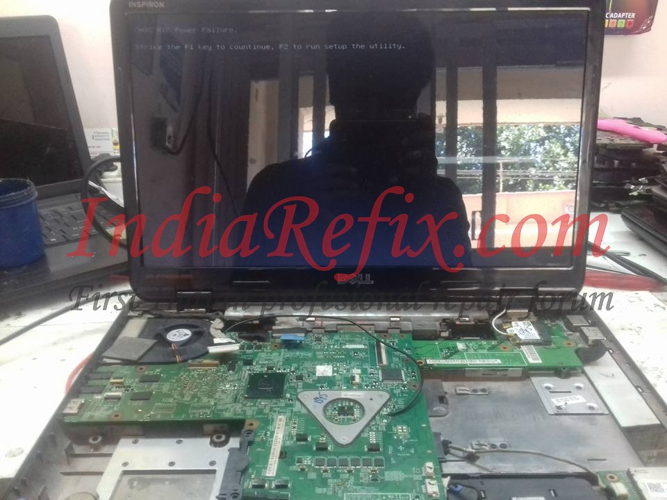

DELL 5010 AFTER DOING GRAPHICS CONVERSION LAPTOP GETTING THREE BEEP SOUND.RAM VOLTAGE (1.5V) MISSING.AFTER CHANGING RAM IC LAPTOP WORKING FINE.
