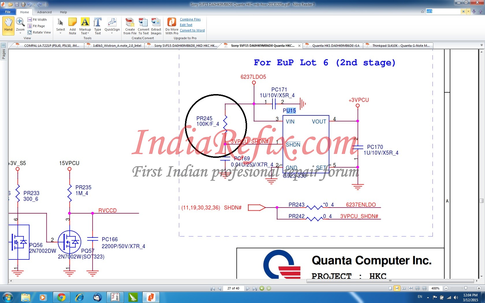

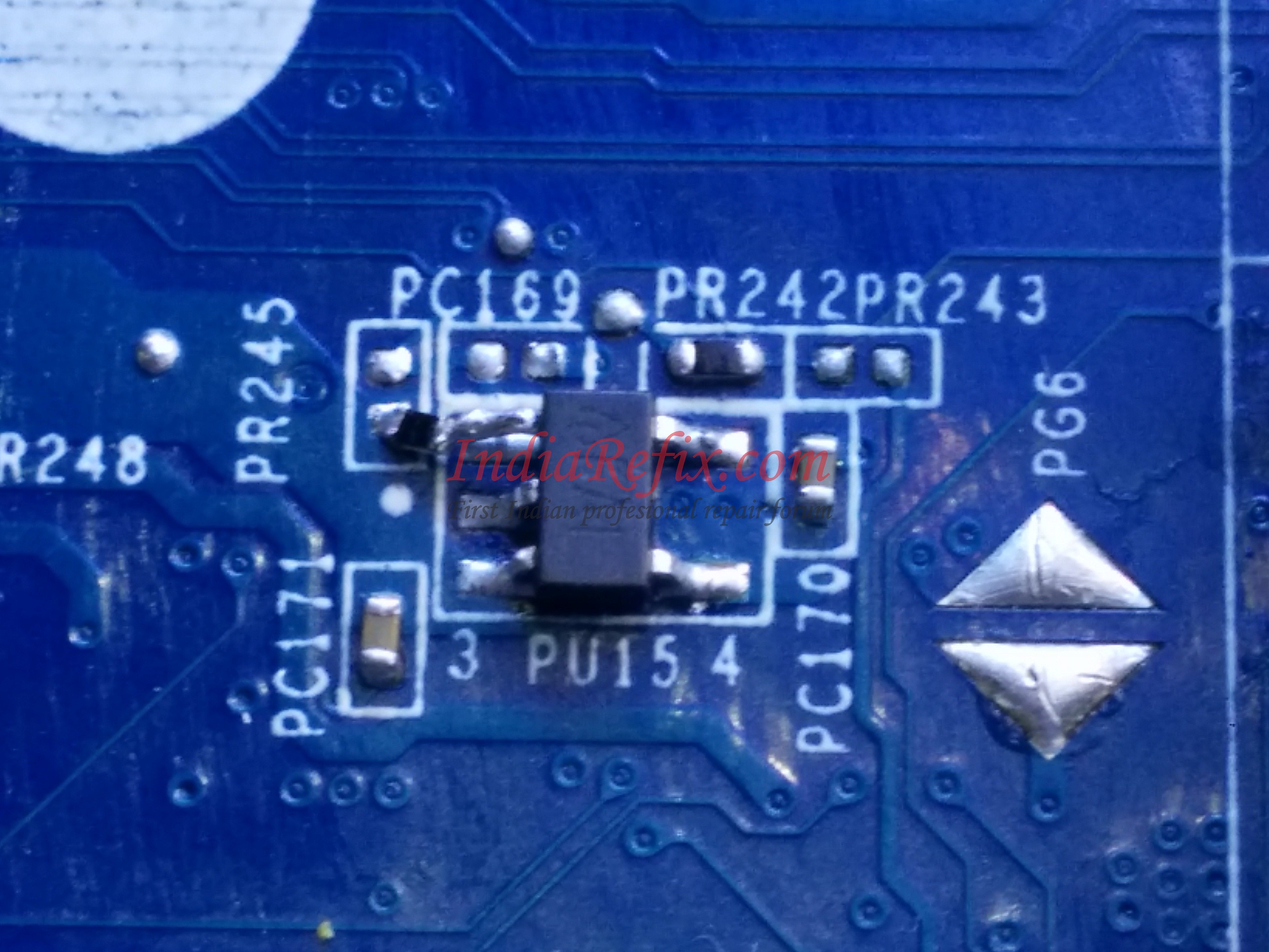

5 Volts to 3volts converter no out put due to black circled resistance failure
Arun.shspl
Posts: 198
Joined: Sun Apr 10, 2016 7:55 am
Location: New Delhi
Re: SonySFV15 Quanta HK9 DA0HK9MB6D0
Post by Arun.shspl »
In this motherboard rtc/ldo supply initialize by this ic pu15 if this ic do not triggered then board seems no load in power supply.
