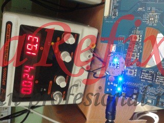

today i m facing no pwer issue in acer aspire 5740 [wistron jv50- cp]
when attached psu its take 0.009 amps..and no led glow...
then i m checking vin volt its ok
after that checking 3d3v coil and 5v_pwr coil and its 0 volt on both coils...
so i m checking whole smps section ....first of check
DCBATOUT = 19v ok,,,
3D3V_AUX_S5=3.3v ok,,
5V_AUX_S5=5v ok.,,,
51123_VREF=2v ok
then check,,, EN0==5.25v ok
ENC=== 0v and its coming from i/o ic... its S5_ENABLE
now i thing may be its i/o chip problem but before change chip reprogram ec bios may be its corrupt...
so i m flash ec bios and sovled problem S5_ENABLE it come
and thats why all voltages come like
3d3v==3.3v
5v_pwr ==5v
and iits indicator light come with different amps..its 0.024...
now switched on and workin fine....thanks....[/hidden]
