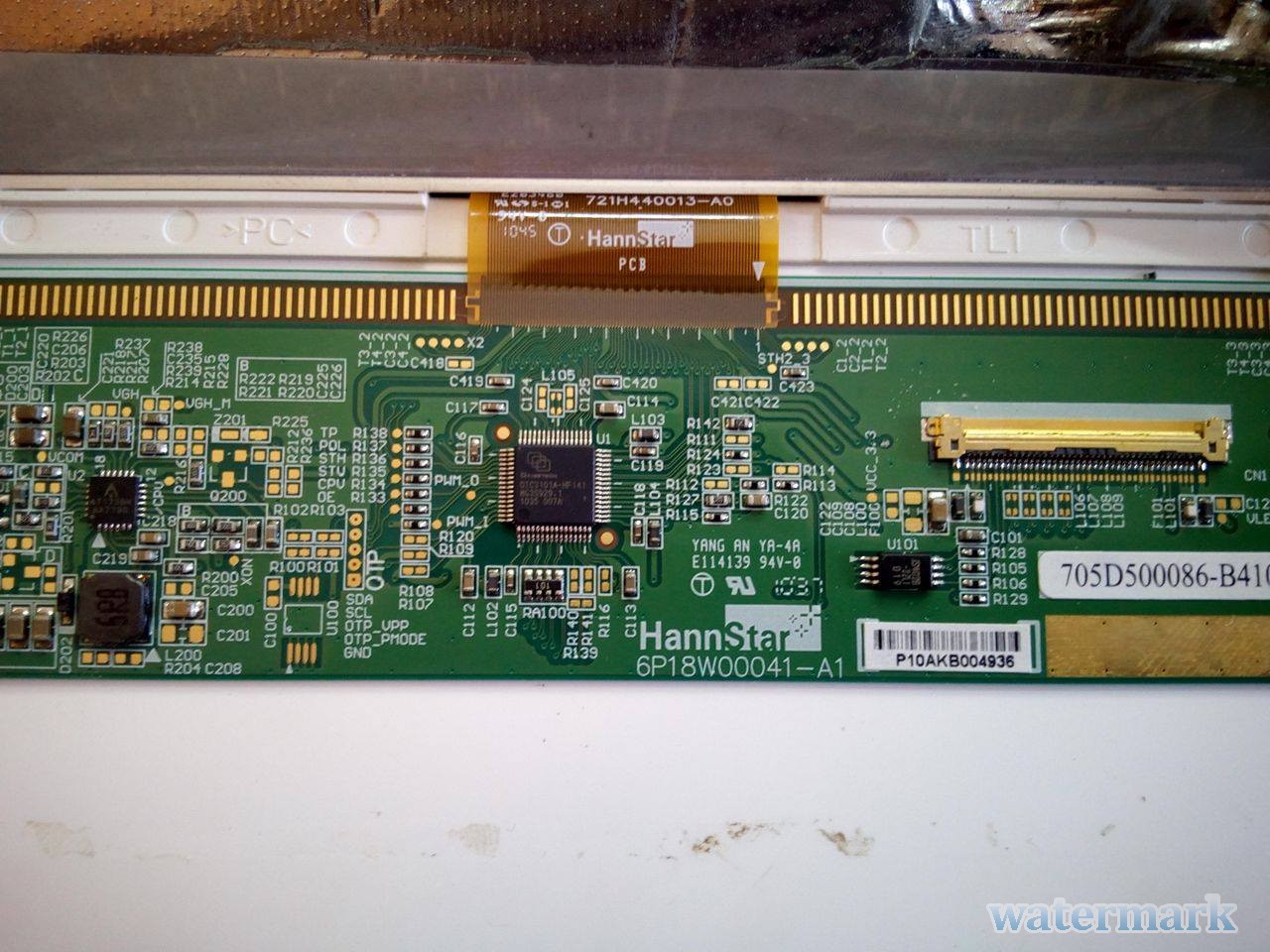

a acer mini comes with dim display check screen other screen comes display,
one change screen or else repair the screen

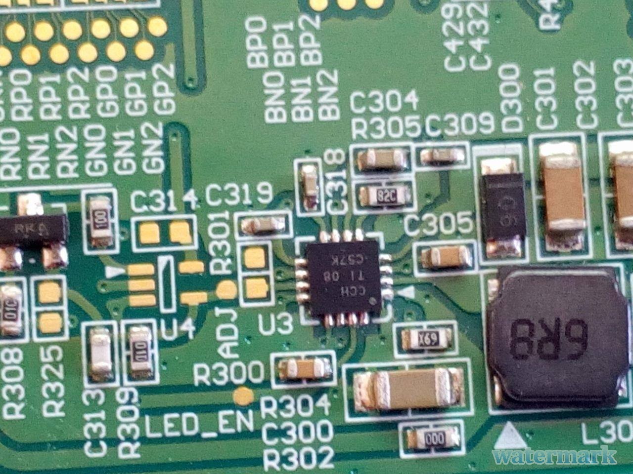

on repair check 19v fuse okk
ic capcitor ok and coil generate voltage 18 v on coil l30 seems every thing ok bt dim display
remind a funda coil generate voltage on frequency so check on oscilloscope just stright line 18 v both side got ans
change ic from same screen its okk
