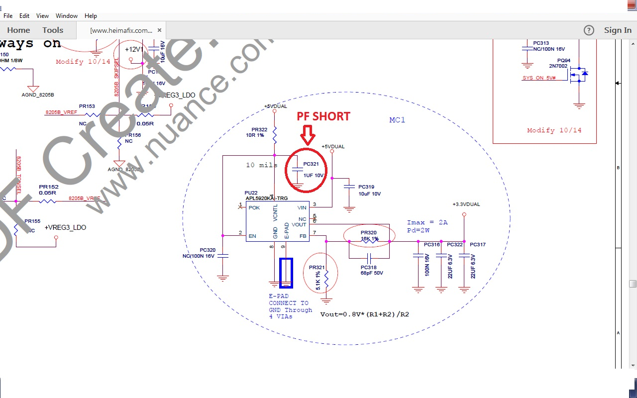

pc321 pf is short replaced the pf.Now PC system is power on with lenovo logo faulty pf picture is attached.....
Lenovo Ideacentre B320 AIO Power on But no Display

When press power button PC system is power on power led blink with LCD flickering but if you press the TV button system power on with display.After tracing the main board found +5vDual abnormal then found

where is picture dear ?
