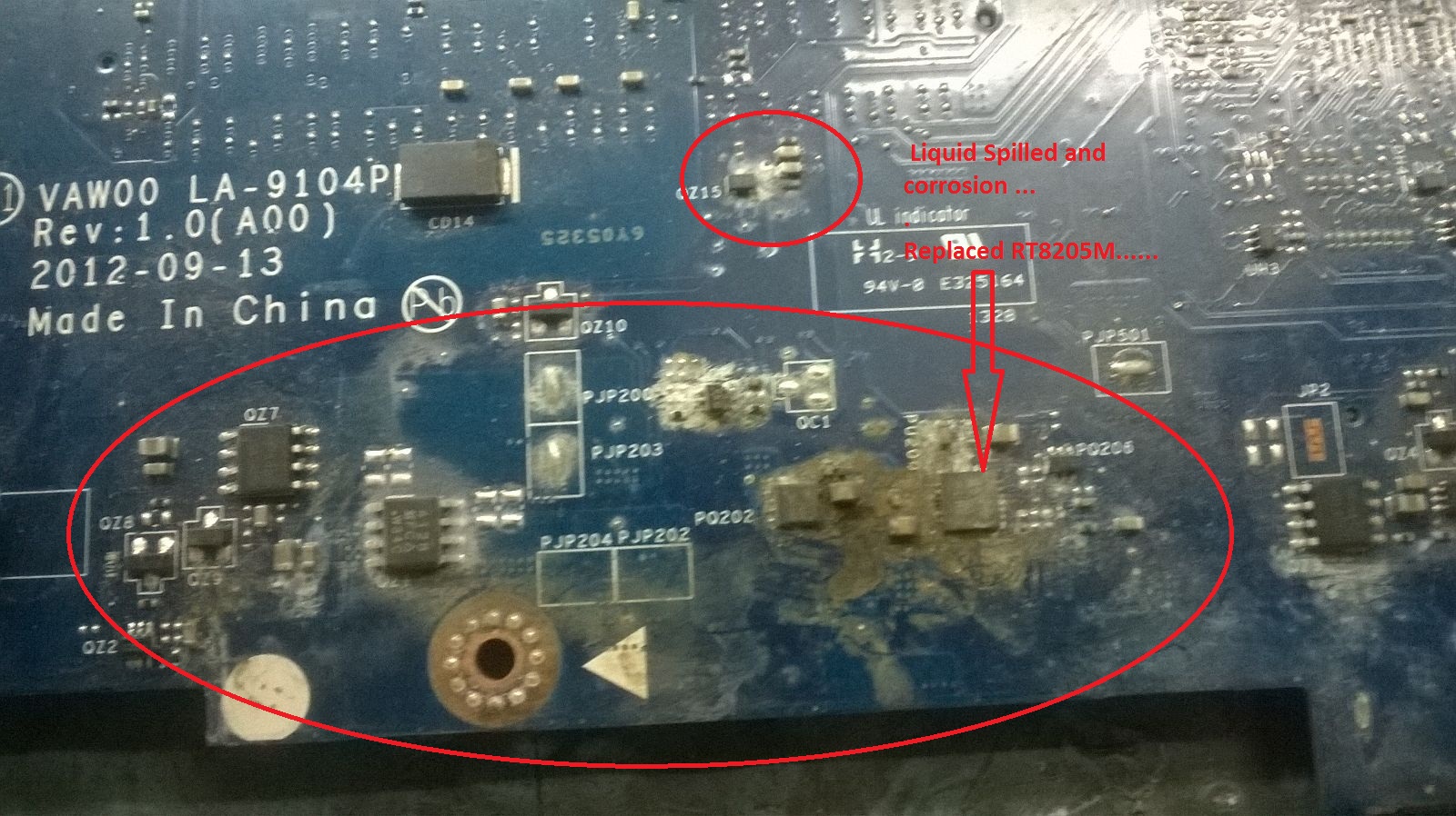

Found Liquid and corrosion near The system controller ...
Cleaned and laid the 19 V track to RT8205M
Replaced RT8205M
System Working fine now
here is the pic
