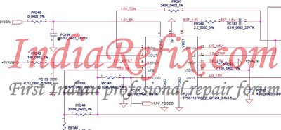

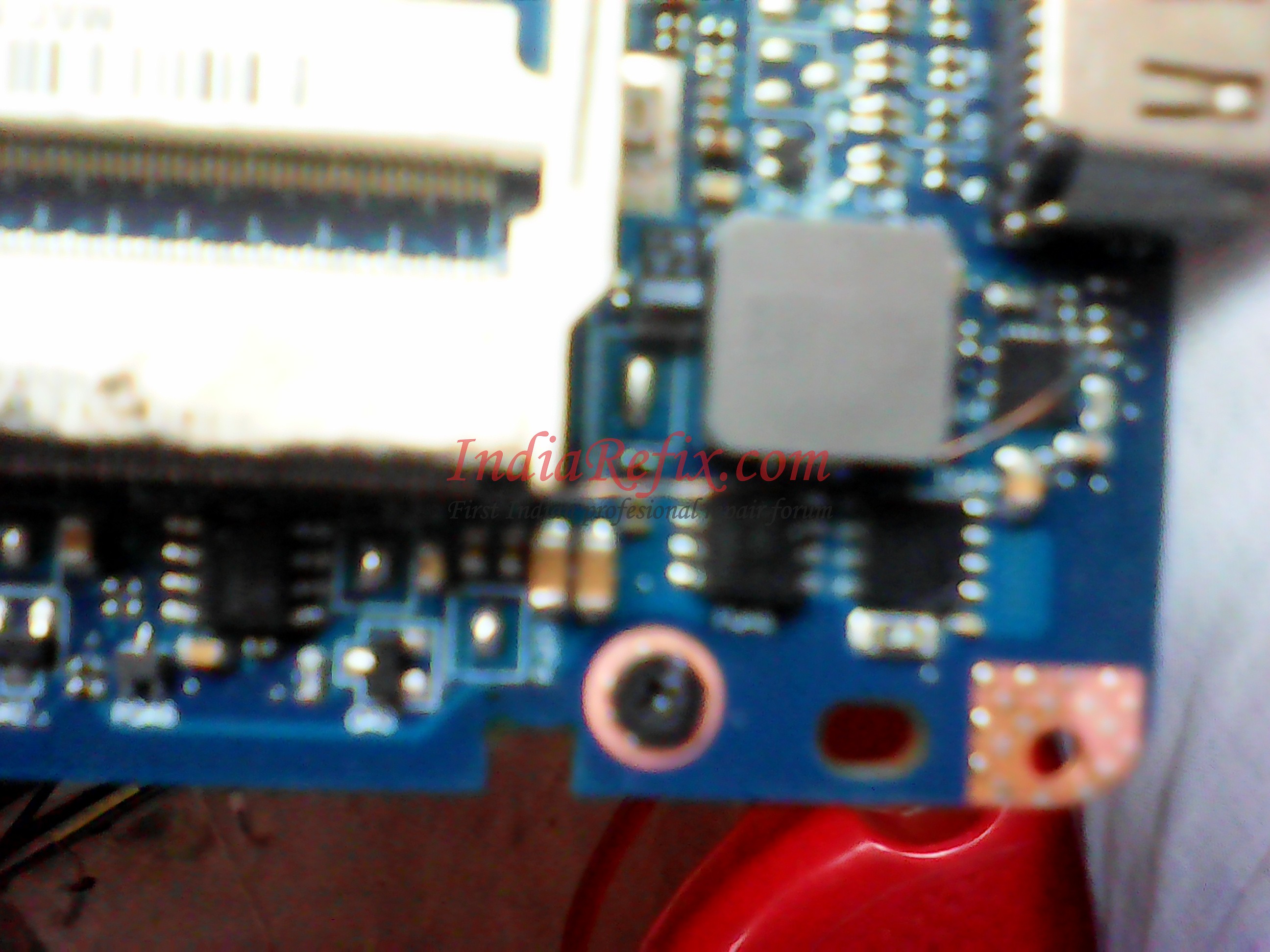

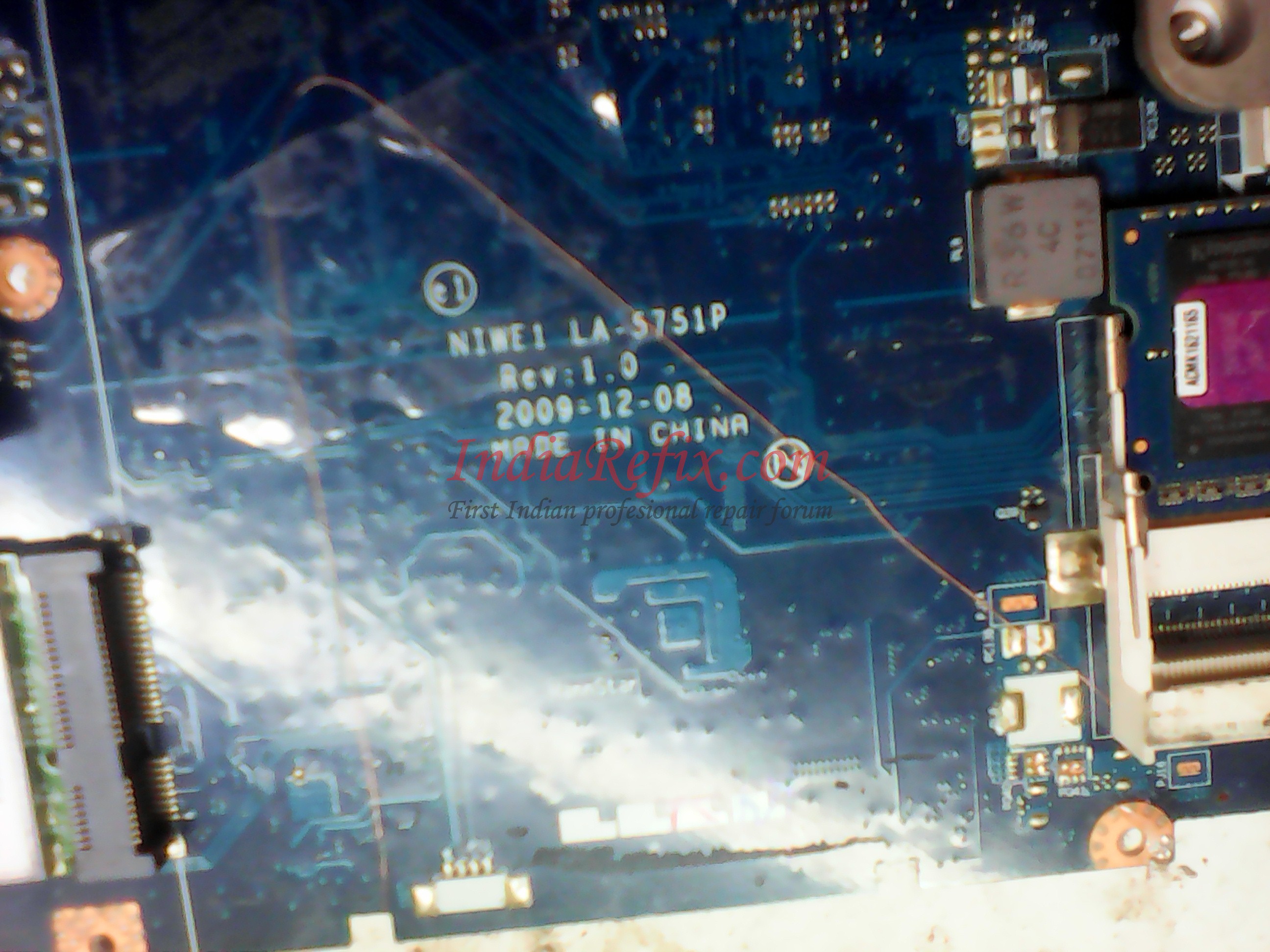

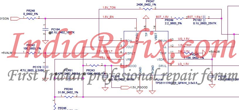

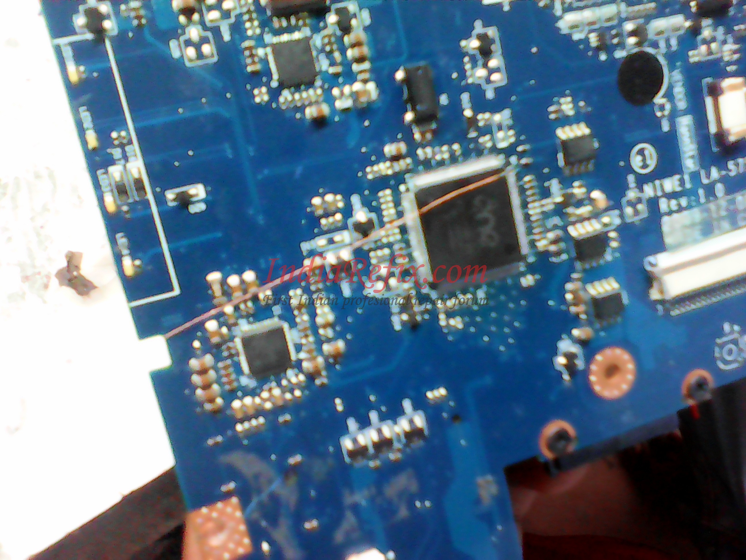

BRAND: LENOVO
MODEL: Z460
BOARD: NIWE1 LA-5751P
WHEN I PRESS POWER BUTTON LAPTOP GETTING SHUTDOWN IN FEW SECONDS.AFTER TRACE THE BOARD RAM IC SIGNAL VOLT MISSING.MAKE A JUMPER FORM IO.LAPTOP WORKING FINE.
LENOVO Z460 SHUTODOWN IN FEW SECONDS.

Re: LENOVO Z460 SHUTODOWN IN FEW SECONDS.
Hahah
Two long wire connection God job
