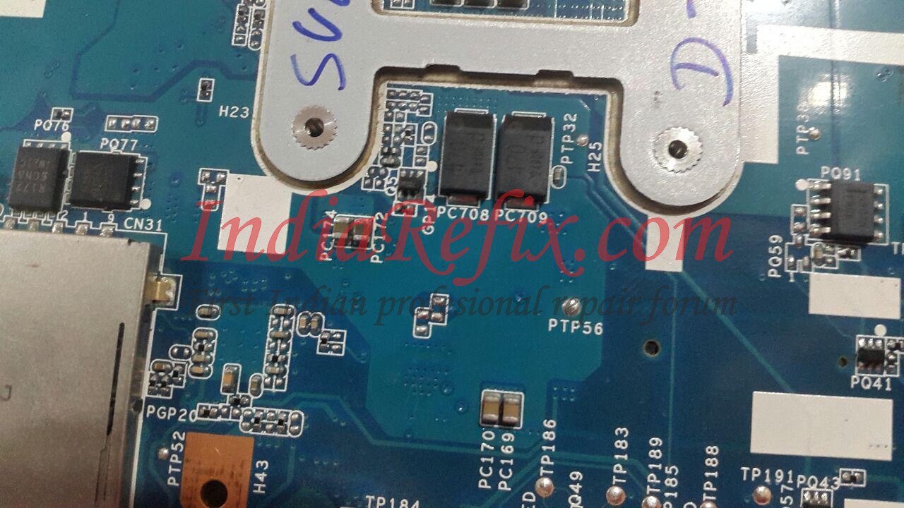

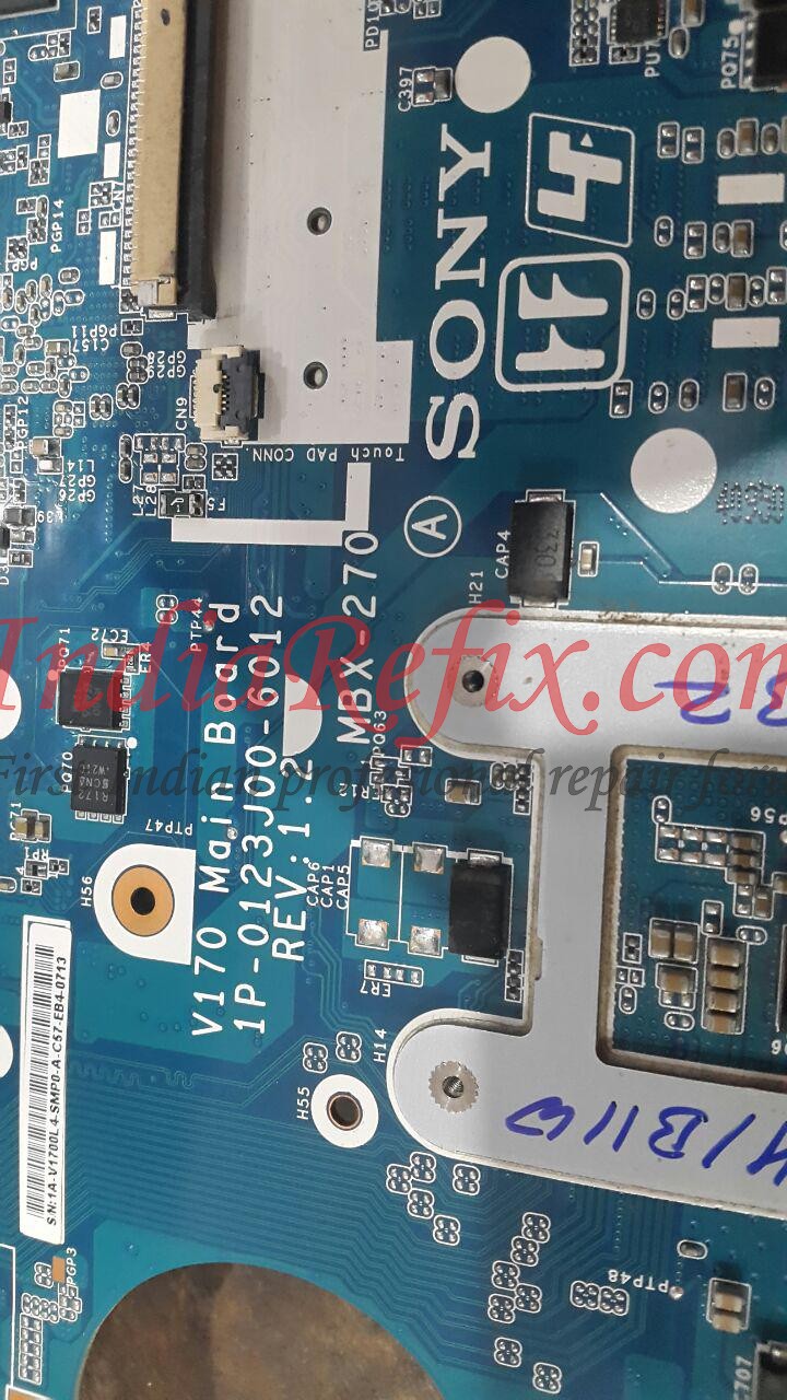

Sony MBX270
Problem Dead
NO PHYSICAL DAMAGE
NOT SHOWING SHORTING ANYWHERE WHEN PUT ADAPTOR 3.3 VOLT GENERTE BUT NOT SWITCHING FOUND 1 CAPS SHORT BACK SIDE OF CPU SOCKET (PC174)CHANGE IT CASE DONE.
