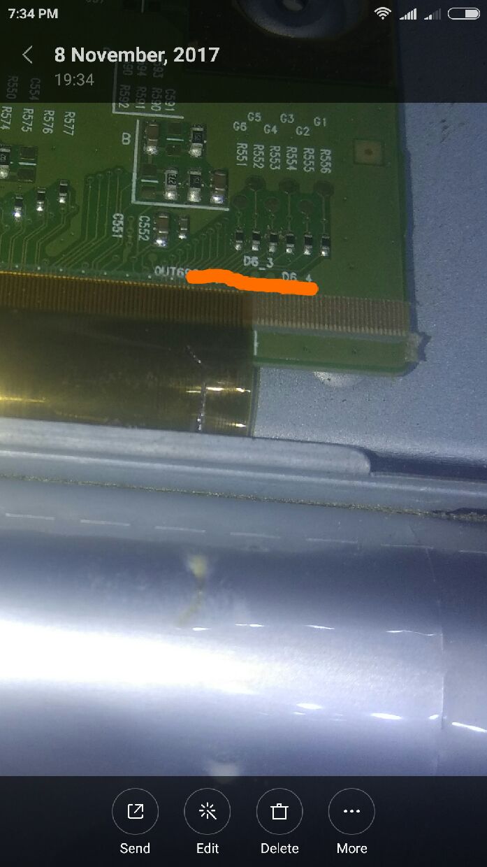

Brand :LG22LN4055
Problem Reported : no-picture Only Vertical Bar in Screen
Its Panel Related Issue
Diagnose : Found Source Cof Burn
Solution : Cut Few Track ( Power related ) With Sharp Blade Now set Working ok
LG22LN4055 Vertical Bar
- Track Cut.jpeg (89.38 KiB) Viewed 20875 times
