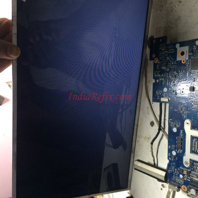

PROBLEM-
NO DISPLAY ONLY LED LIGHT COMING
DIGNOSIS
CHECKED WITH PENDRIVE EXTERNAL DISPLAY COMING
MEAN DATA COMING IN USB
THEN CHECKED WITH OTHER DISPLAY PANEL SAME ISSUE
THIS LED DISPLAY WORKING FINE IN OTHER BOARD
THEN CHECKED WITH OTHER CABLE LED ALSO SAME ISSUE
THIS CABLE WORKED IN OTHER BOARD

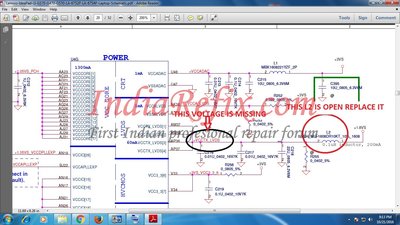

THEN GO TO CHECKED FOR LCDVDD VOLTAGE ALL ARE FINE (3.3V)
LED VOLTAGE ALSO OK 19V
THEN I SUSPECTED FOR ISSUE IN PCH

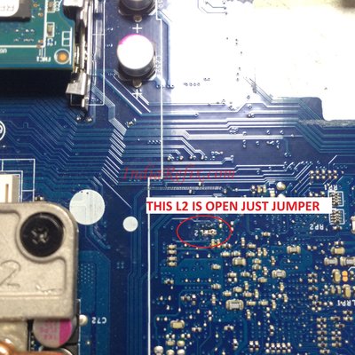

THEN I CHECKED PCH FOR LVDS SECTION AND FOUND +VCCTX_LVDS IS MISSING (1.8V)
THIS VOLTAGE IS GOING TO PCH THROUGH L2 COIL LINE
THIS L2 IS OPEN
RESOLUTION
JUST PUT A JUMPER IN L2 AND CHECKED WORKING FINE

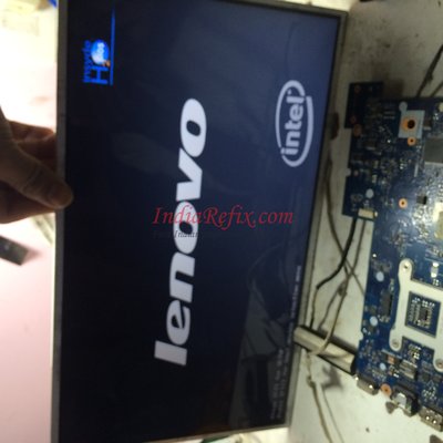

THEN DISPLAY IS COMING
LVDS SECTION NEAR PCH
NOW DISPLAY OK AFTER REPLACE L2 OF VCCTX_LVDS
THIS IS L2 OPEN REPLACE THIS WITH JUMPER
THIS IS FAULT NO DISPLAY

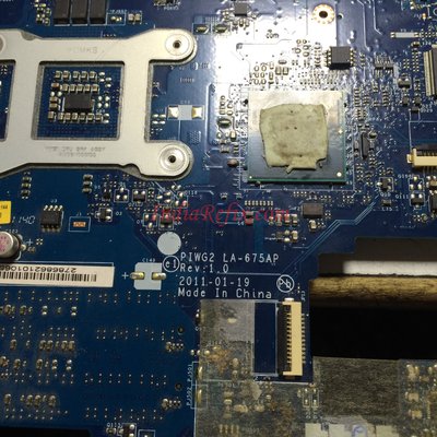

BOARD PART NUMBER
BOARD PART NUMBER
