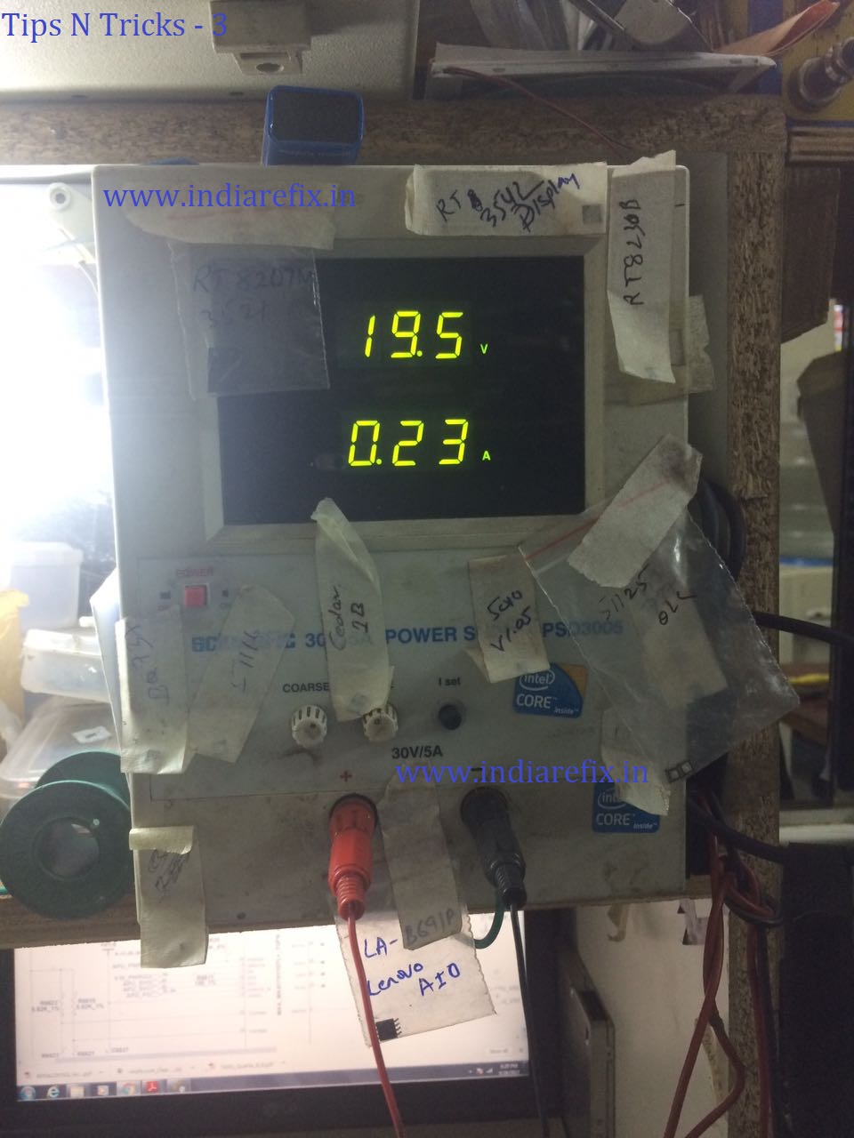

PSU Readning - shows up the load of 0.23 amps and keep on restarting

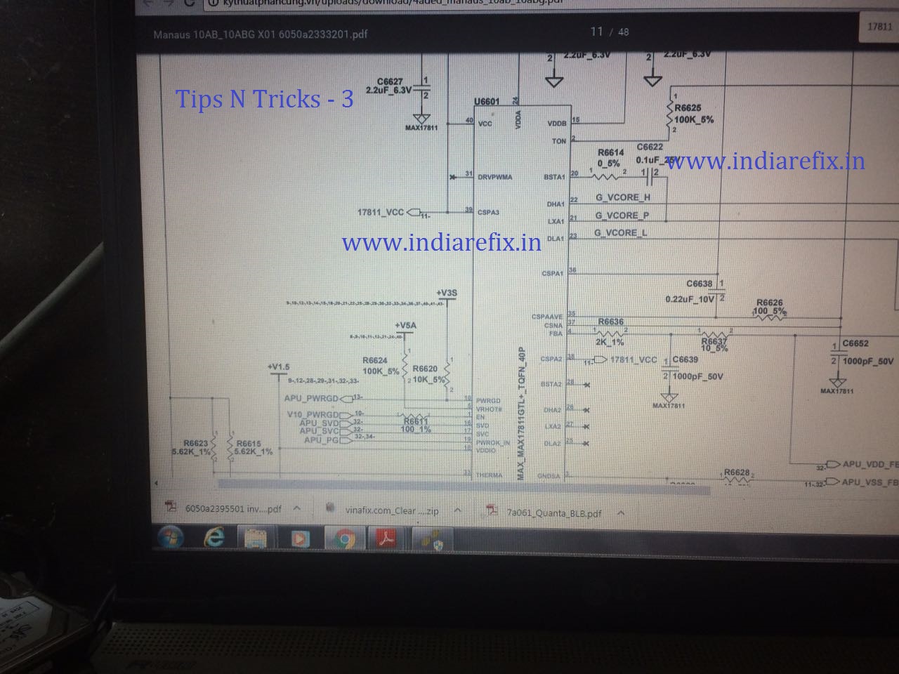

So searching same chipset for other schematic for cross reference with same vcore ic ..
Found that almost all requirements was available of vcore ic , like , VCC, VDD, VRON was available . but TON pin has no voltage the pin is connected to a resistor and when tested the resistor for value found it open
While the reference schematic says that it should be around 100k

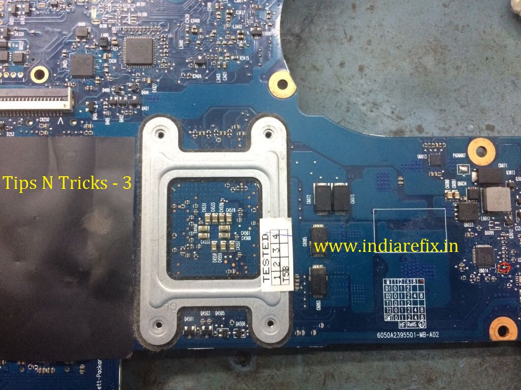

Just changed the resistor and vcore started generating
As the board had no marking reference for resistor I have marked it in the pic.
