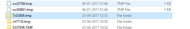

Step:3
Temp Folder
Temp Folder
Temp Folder.JPG (20.46 KiB) Viewed 12506 times

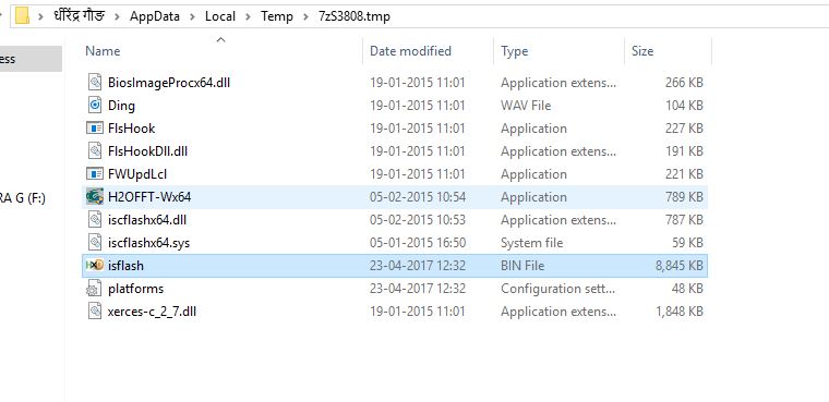

Step:4
Found Bin File
Found Bin File
Found Bin File.JPG (45.2 KiB) Viewed 12506 times

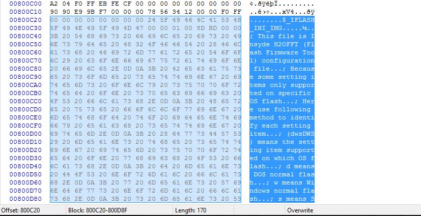

Step:5
Found Bin File Size is large size open this file Bios Editing tools and go to Offset 00800c20
GO to Offset Location 00800c20
Step:6
After Going Offset 00800C20 Location Select all Contain And Erase
Erase All contain Down position.JPG (110.18 KiB) Viewed 12506 times
Step:7
Save File with .bin extansion name
Save File.JPG (110.51 KiB) Viewed 12506 times

Open Temp Folder
Open Temp Folder
