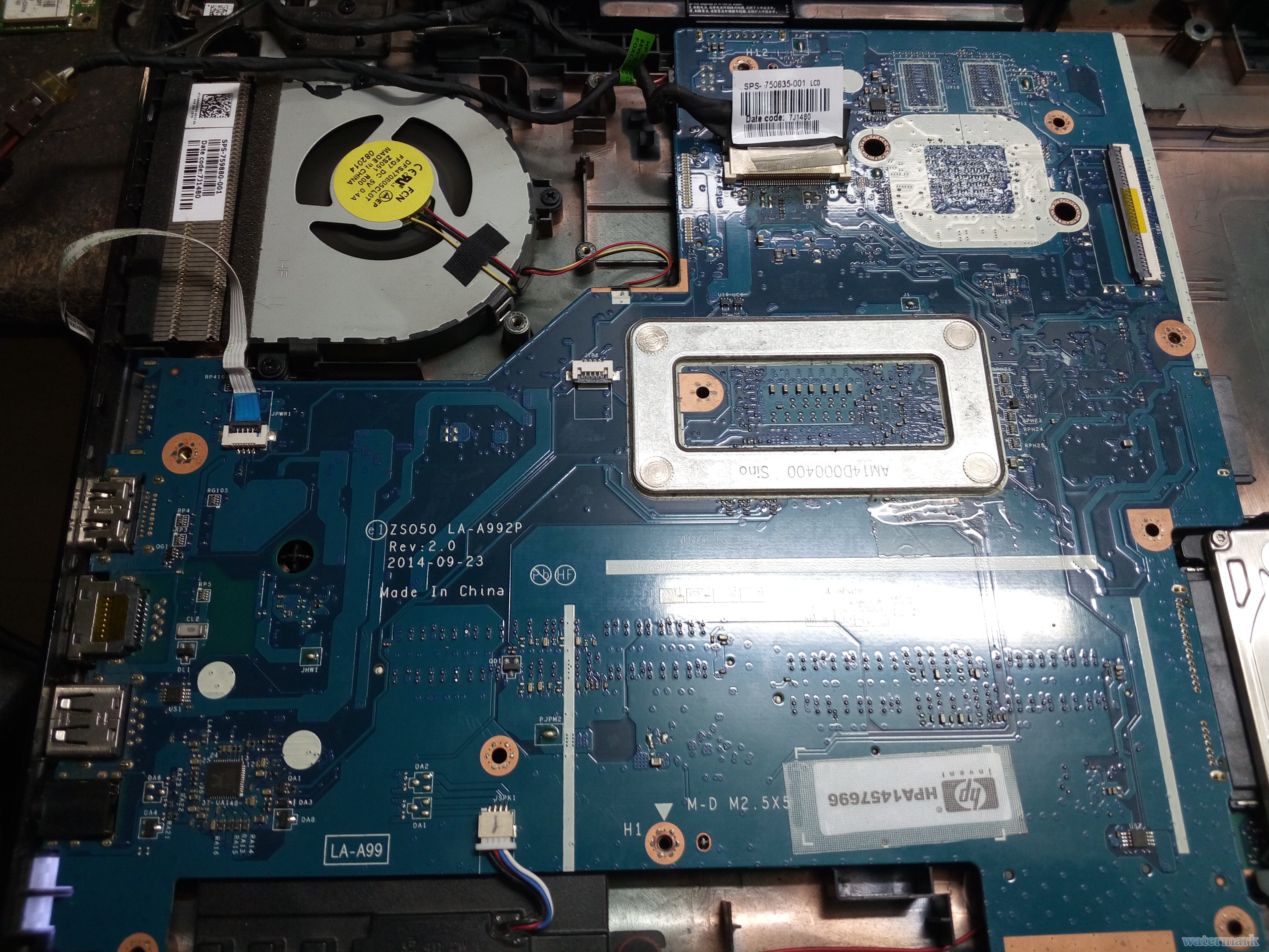

HP 15-R074TU
PART NO ZS050 LA-A992P
CPU -SR1EK
I/O ENE KB9012QF A4
POWER ON--- NODISPLAY ( AMP 0.45)
AFTER BIOS RE-FLASH IT COMES DISPLAY :o
NOW ITS WORKING FINE
