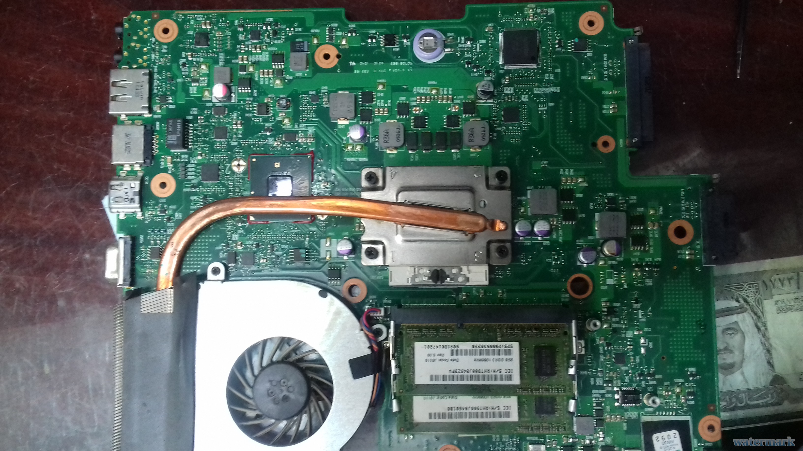

Tosshiba satellite L650-1PD
PART NO: PSK1EE-0D600TAR
M/B NO: 6050A2332402-MB-A02-TI
Hai.....getting only white screen..
change screen...cable..Q3000....HOW TO SOLVE THIS ISSUE...
Tosshiba satellite L650 WHITE SCREEN Solved

Re: L650 WHITE SCREEN
check lcd_vdd
sivakumarkollam
- Posts: 12
- Joined: Wed Feb 17, 2016 6:17 pm
- Location: https://t.me/pump_upp
SOLVE THIS ISSUE FOR CHANGE CONNECTOR....

Re: Tosshiba satellite L650 WHITE SCREEN Solved
according to schematic first lcd-vdd
problem solved - locking post.
