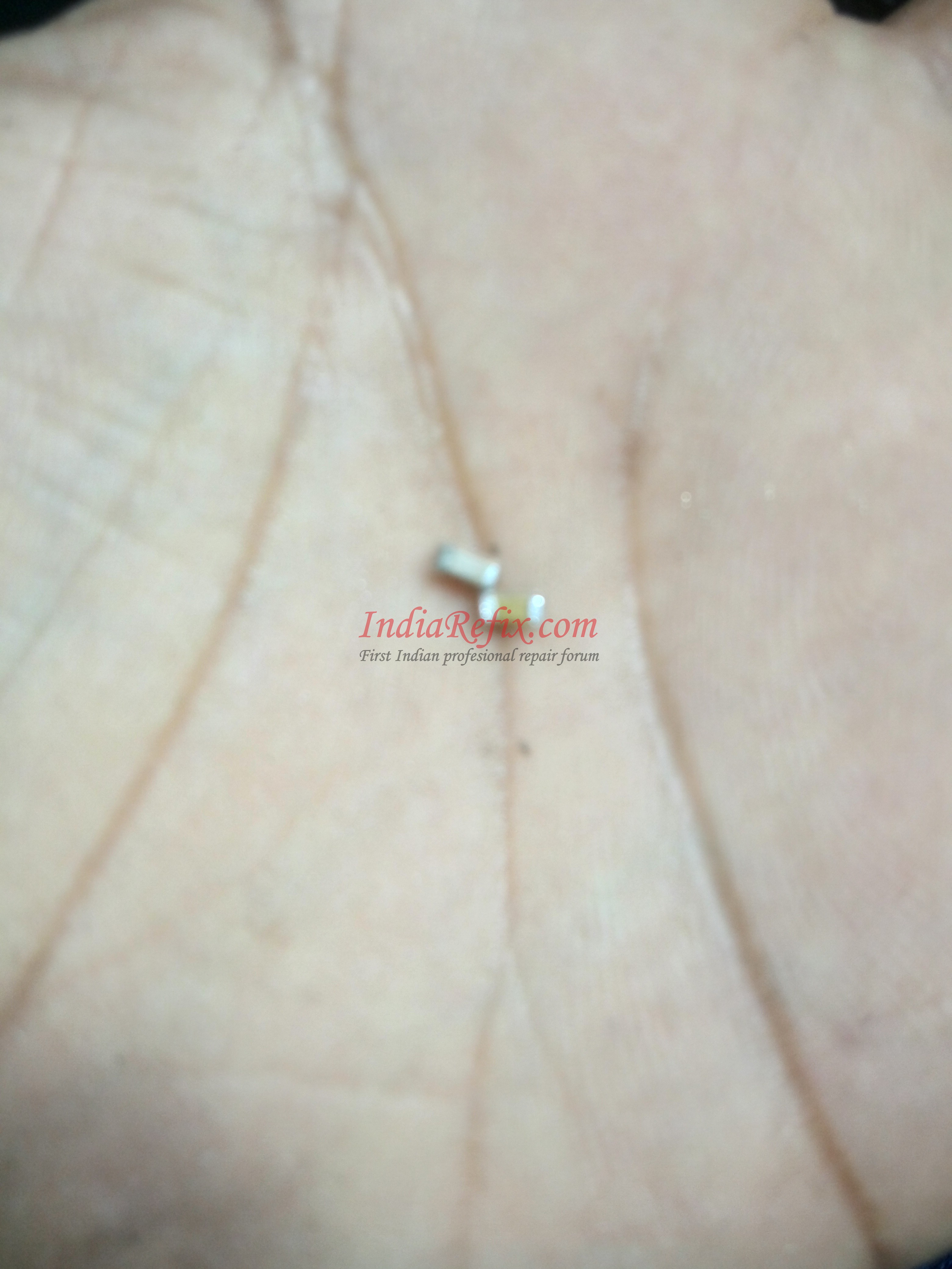

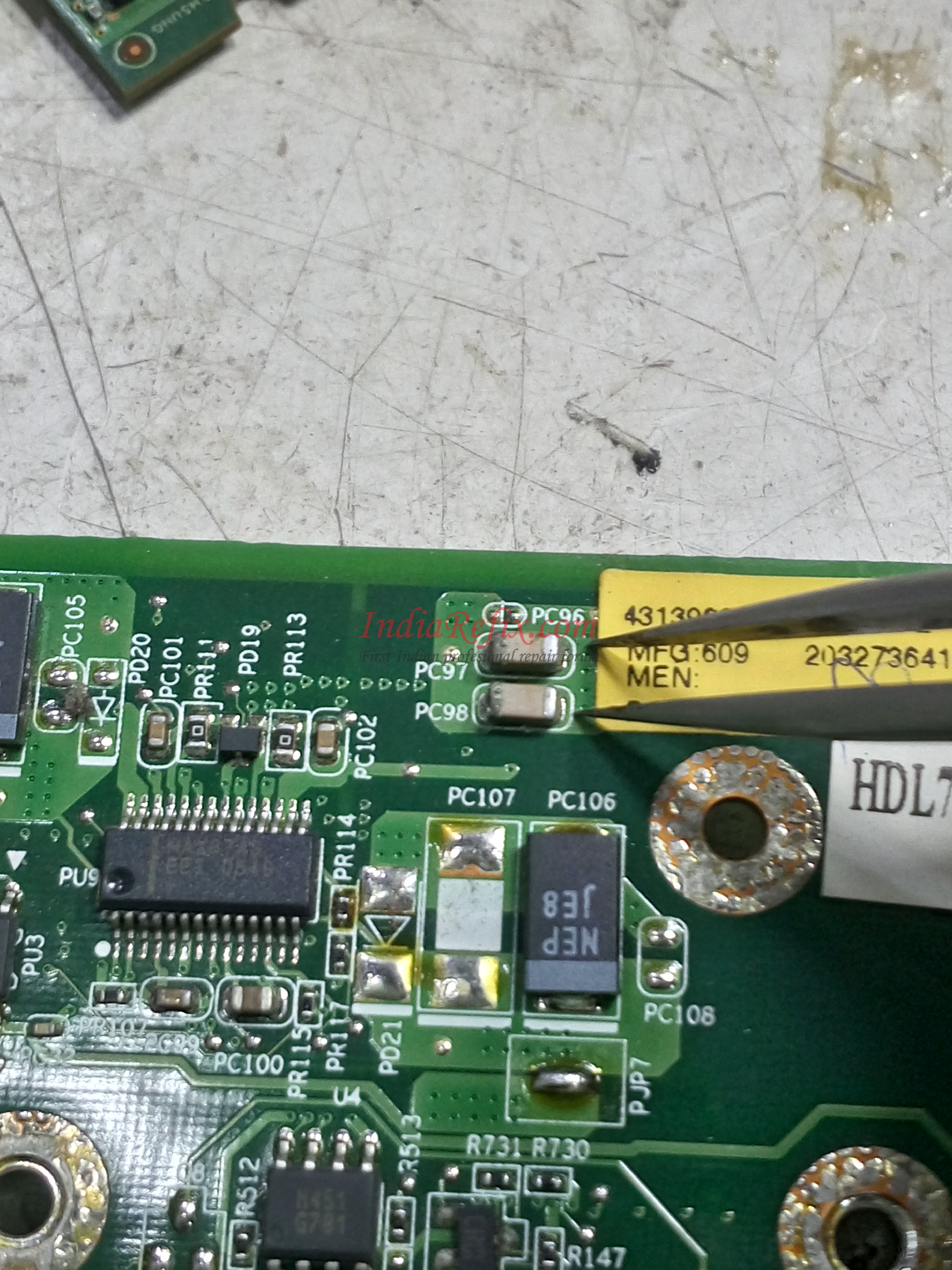

THE MOTHER BOARD WAS DEAD
NOT GETTING DC IN 19 VOLT
FOUND TWO CAPS SHORT
REPLACED AND ITS WORKING FINE
