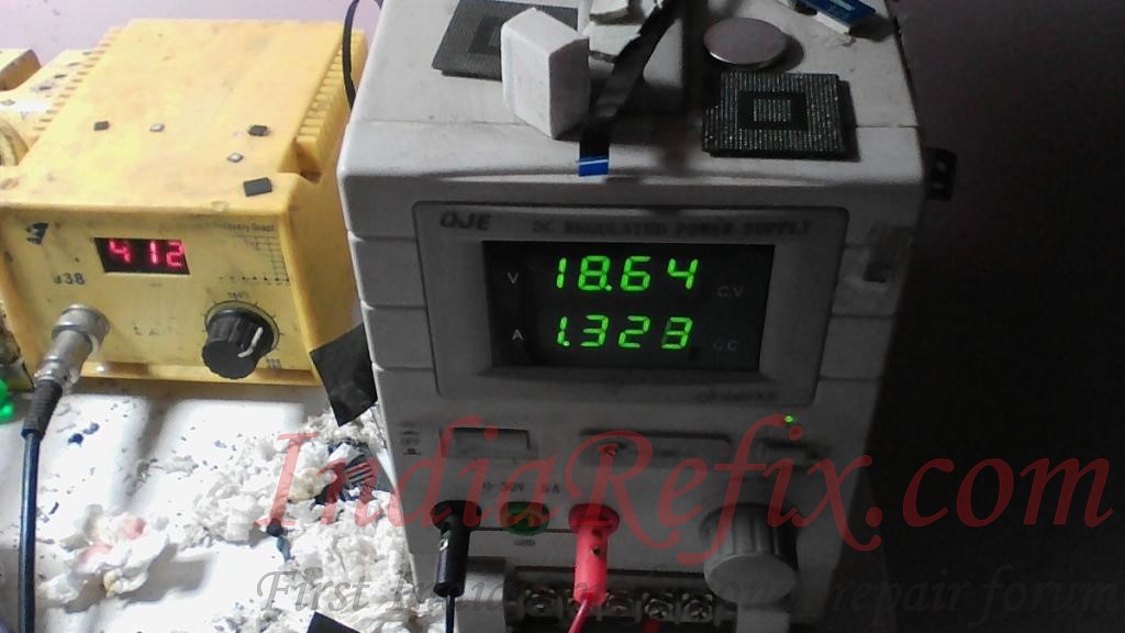

CHECKED THE DC AMP IT CONSUME .300AMP (SUSPECTED SHORTING ISUUE)

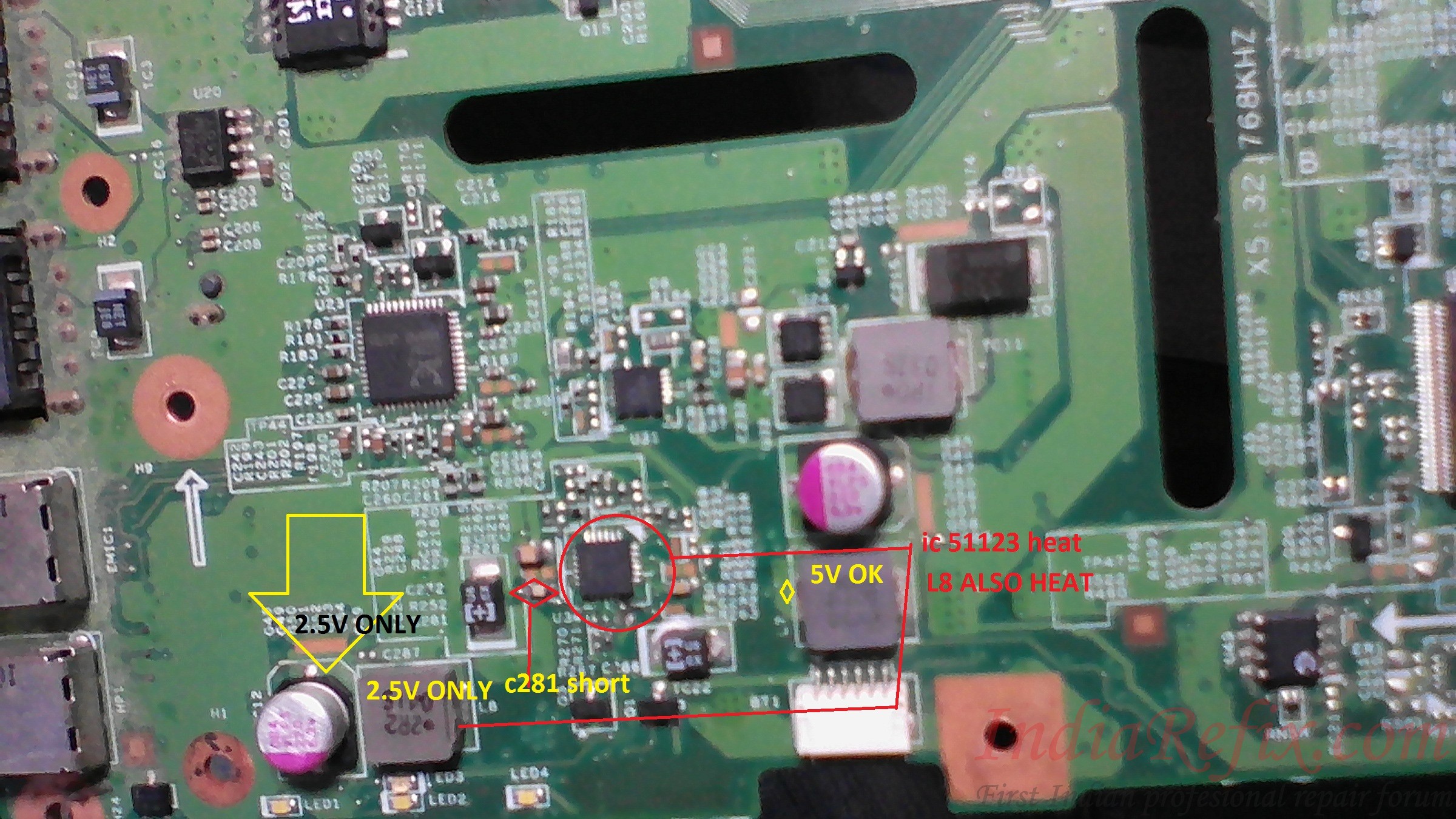

CHECKED THE 3.3V/5V COIL( L8-L9) FOR SHORTING BUT DIODE MODE 390ohm ok
but L8 3.3v line heat excess and only 2.5v insted of 3.3v
L9 5V OK NO HEAT
SO I AM CONFIM IT ONLY PROBLEM WITH 3.3V LINE OF STEP DOWN
SO I AM CHECKED THE STEPDOWN IC 51123 VREG3 & VREG5 PIN 8 & 17 , HERE 3.3V, 5V OK
SO THAT CONFIRM 51123 IS ALMOST OK

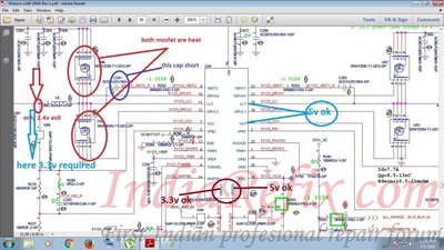

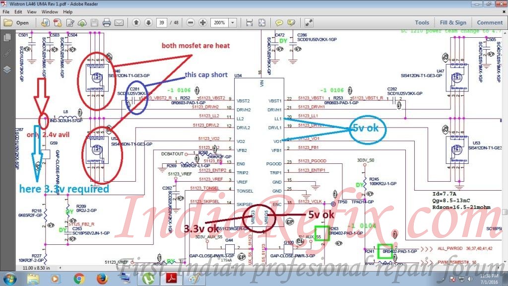

SUSPECTED GO TOWARD VO2, AND LL2 PIN OF 51123, HERE ALSO 2.5V INSTED OF 3.3V
MEANS VOLTAGE DROP FOR ANY SHROT OF CAP OF LINE 2 OUTPUT
SO THAT CHECKED THE VBST2 AND IT SHOW ME SHORT WITH LL2, VO2 PIN
VBST PIN AND LL2 PIN ARE CONCTED WITH C281 CAPCITOR AND CHECKED IT FOUND SHORT
FINALLY FOUND C281 SHORT

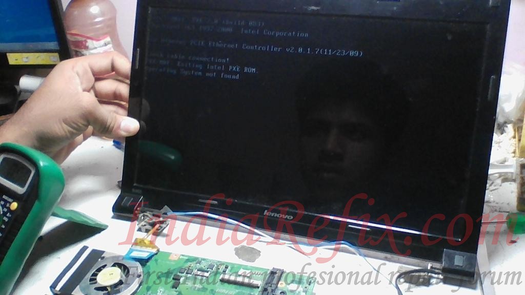

REPLACE THE C281 WITH NEW ONE AND CHECKED 3.3V OK 5V OK AND NOW BOARD ON
DONE DISPLAY OK AMP CONSUPT MORE THEN 1AMP
now ok with display
now ok with display
dc amp consuption
dc amp consuption
schematic checking pont
BOARD CHECKING POINT L8 ONLY 2.5V

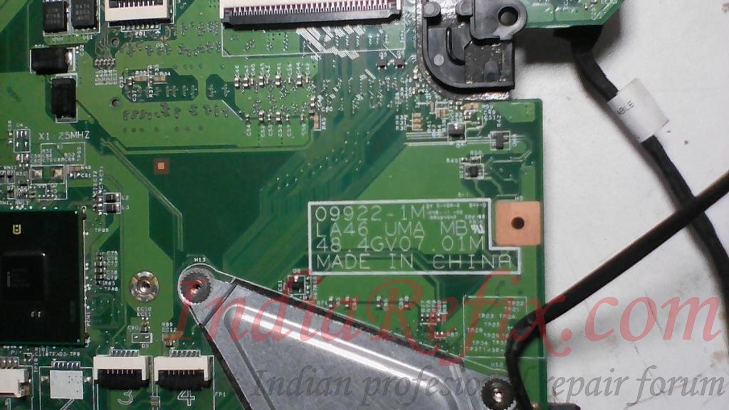

BOARD PART NUMBER
BOARD PART NUMBER
