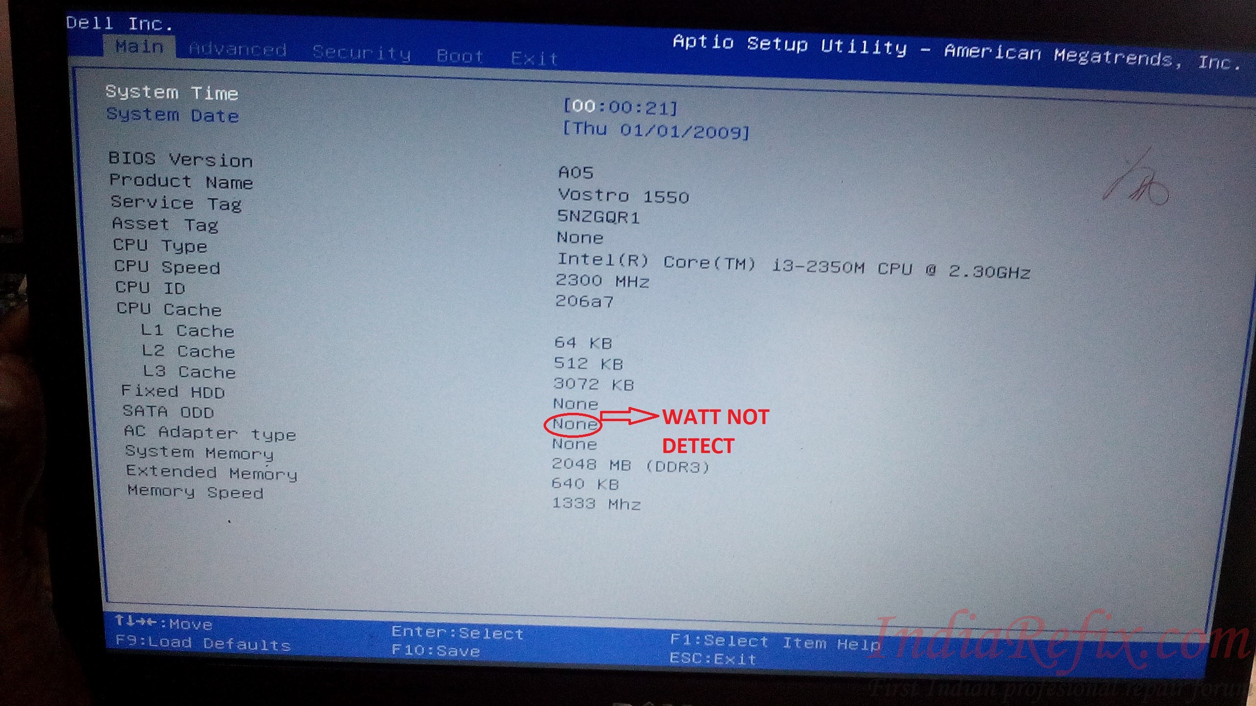

BATTERY NOT CHARGING ADAPTER WATTAGE CANT DETECT
M/B- DV15 HR
CHECKED WITH OTHER BATTERY AND DELL ORIGINAL 65/90W ADAPTER ALSO NOT DETECT THE WATTAGE

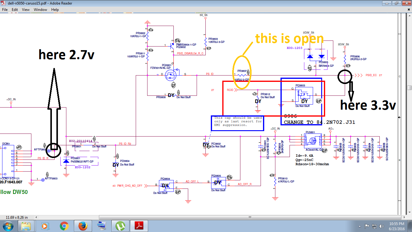

SO I AM GOING THOUGH SCHEMATICS FOR ADAPTER PS_ID VOLTAGE AND TRACK
FOUND 2.7 V IN DC JACK PS_ID PIN
CHECKED AND FOUND PS_ID EC VOLTAGE IS OK 3.3V PR3806
SO I AM CONFIRM MAY BE SOME RESISTOR OR TRACK BURN

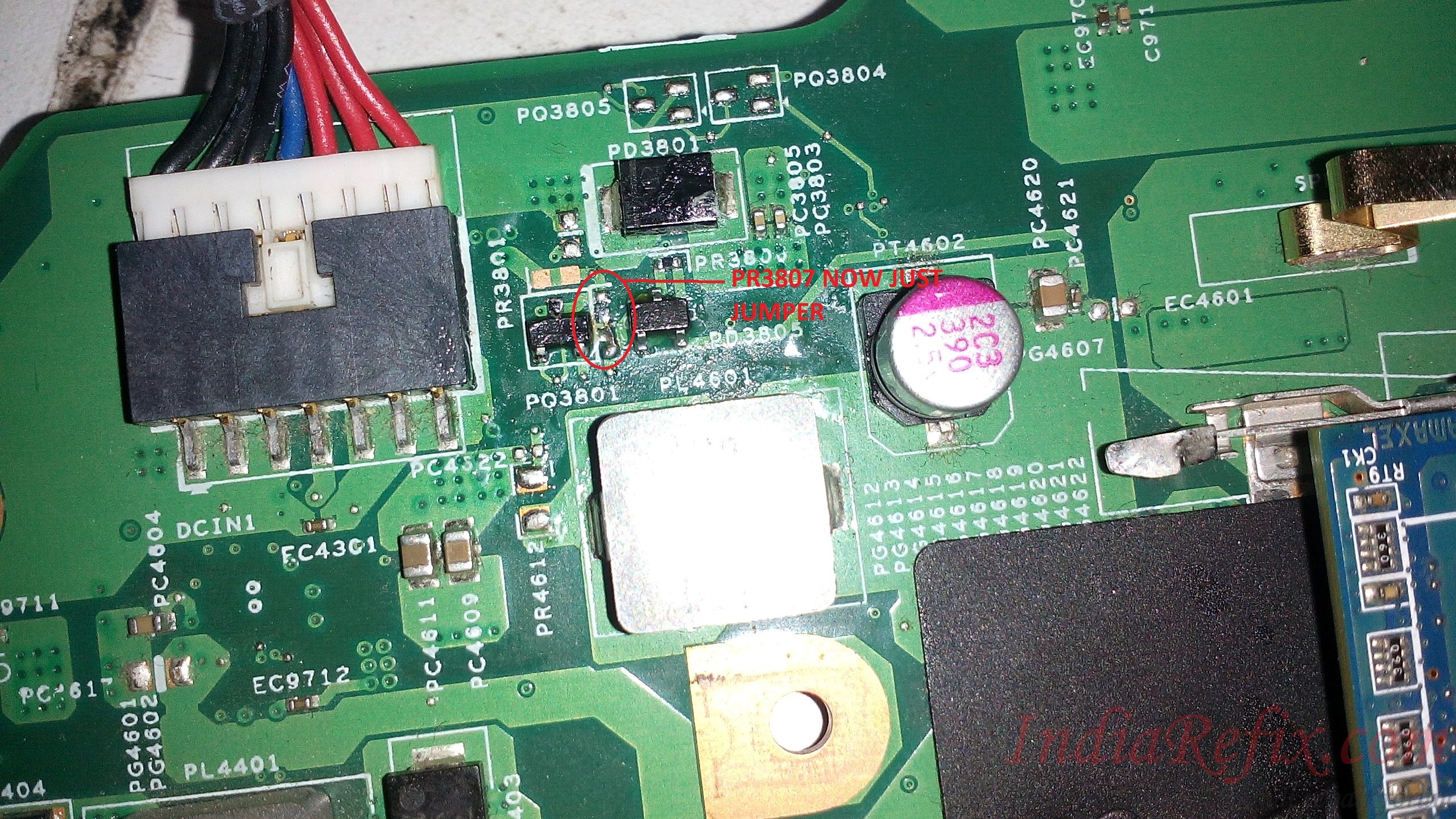

CHECKED ONE BY ONE AND FOUND PR3807 IN BETWEEN PS_ID AND PSID_EC IS BURN
THIS IS 33OHM SO THAT I JUST JUMPER IT AND GETTING 3.3V IN PS_ID PIN NEAR DC JACK IN

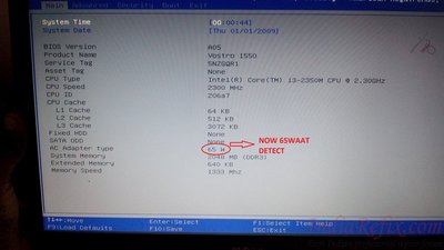

NOW DELL 65W DETECT IN BIOS AND BATTERY ALSO CHARGED PROPERLY
NOW PROBLEM RESOVED AND BOARD WORKING FINE

JUST REMOVE PR3807 AND PUT A JUMPEER ONLY
