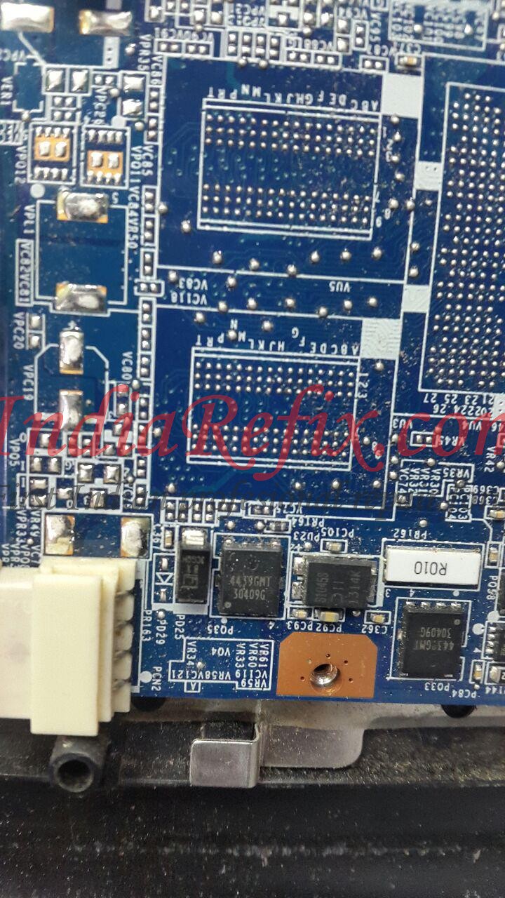

Sony hk9 condition dead found no volt on board check 1st 19 volt output mosphet found 19 volt source and get no volt on drain replace PQ35 this with 4409 now OK. ..[glow=red][/glow]
