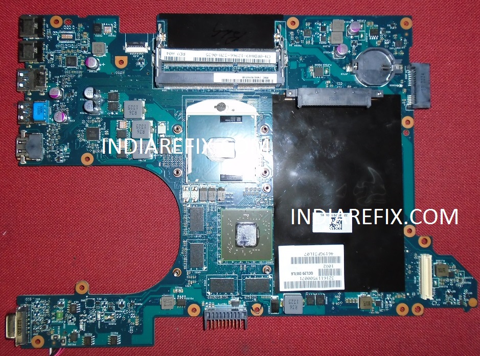

Dell Insprion 5520 Dead
Motherboard Part No-QCL00 LA-8241P Rev-1.0
Problem- Dead

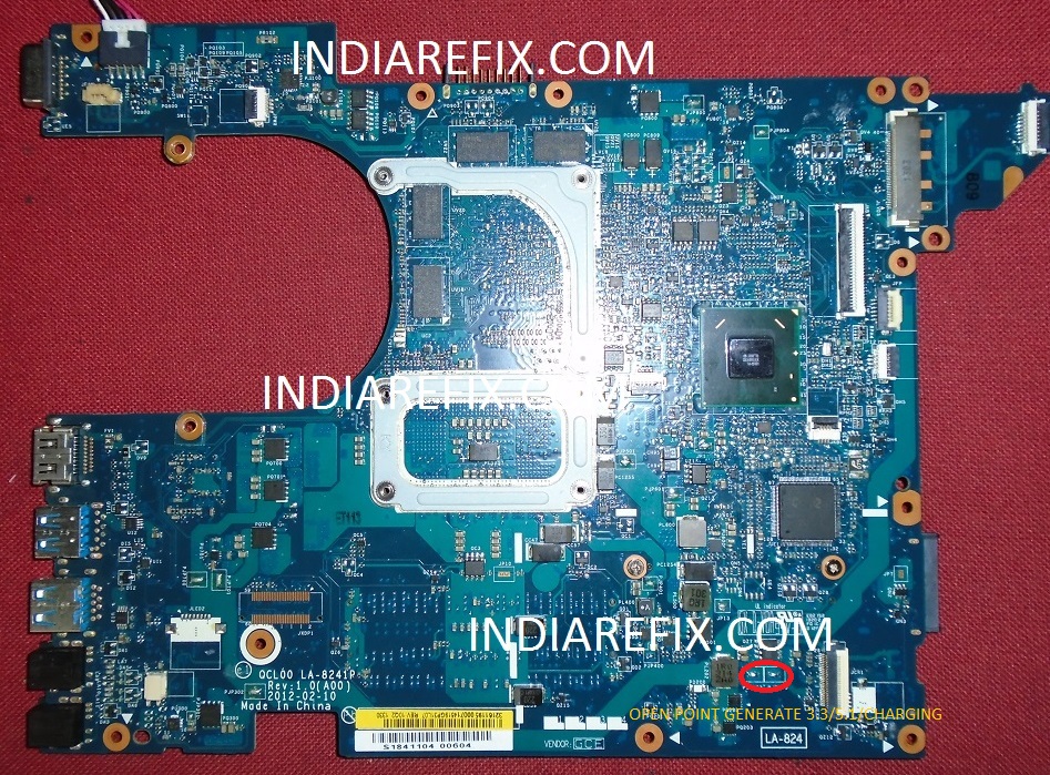

Diagnosis- Found 3.3v line shorting
Process-
+19V Working
Charging Voltage Not Working
StepDown Voltage Not Working

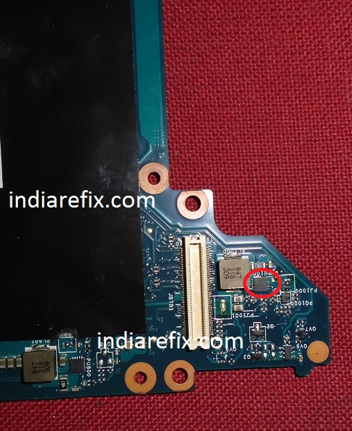

Found Problem 3.3V Line shorting Remove shorting (PU1000 Replaced ) problem solved

Good sir ji per short kya tha sir plz tell with pic if possible
Re: Dell Insprion 5520 No Display
yashan wrote:Good sir ji per short kya tha sir plz tell with pic if possible
pic uploaded
