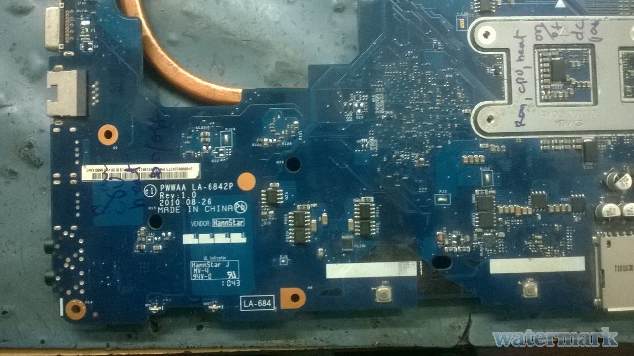

Make/Model- Toshiba C660
Motherboard Part No- LA-6842P
Processor Type- I3
Ram Type – DDR III
Problem – Power on No Display
Diagnosis- I /O
Process-
Laptop Power on and PSU takes upto 0.45 Amps …. Vcore ic was already replaced by previous enginner …..Try to flash bios ….but the Same out put ……the Replaced the i/o controller and the job done ……
