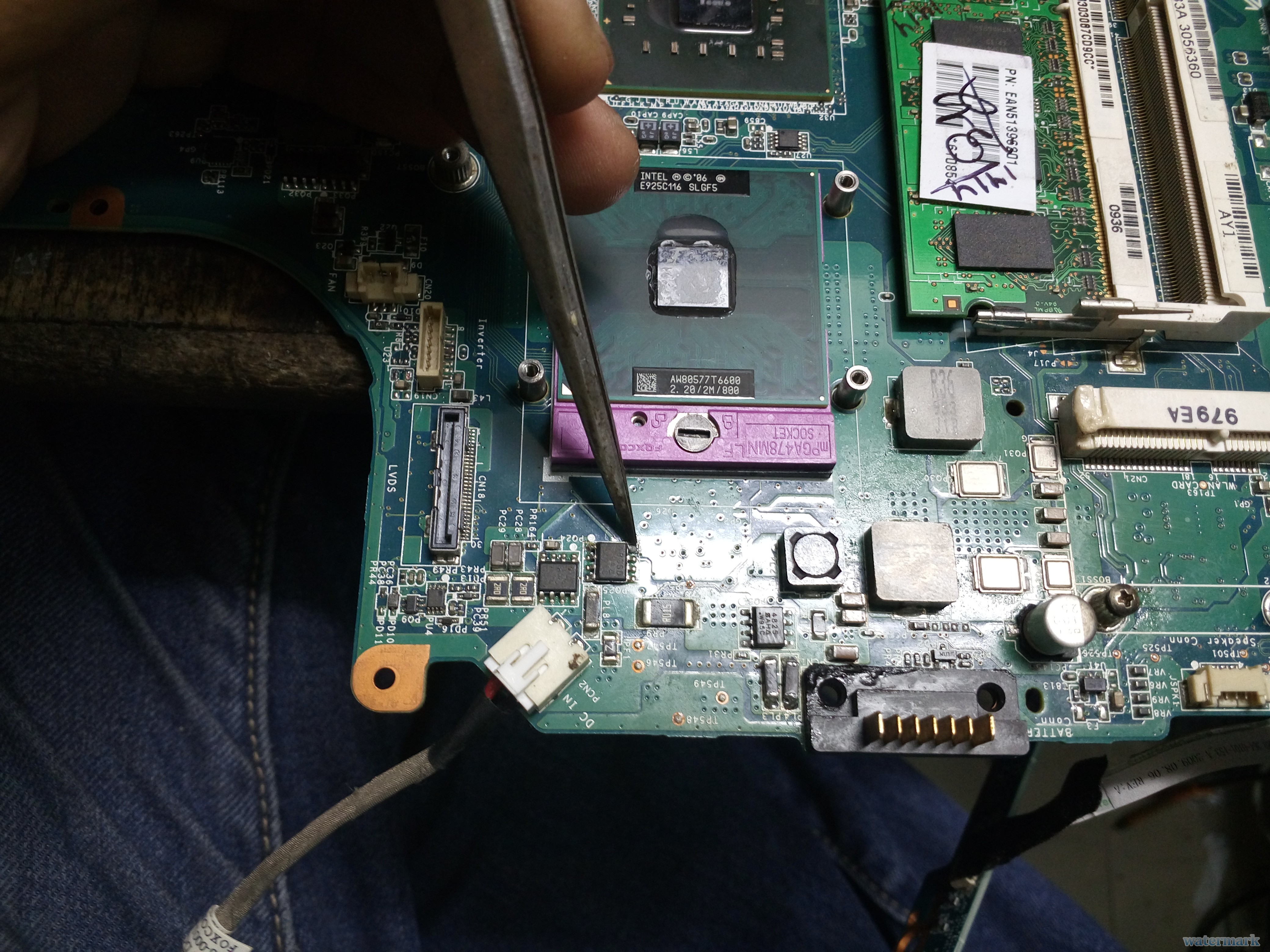

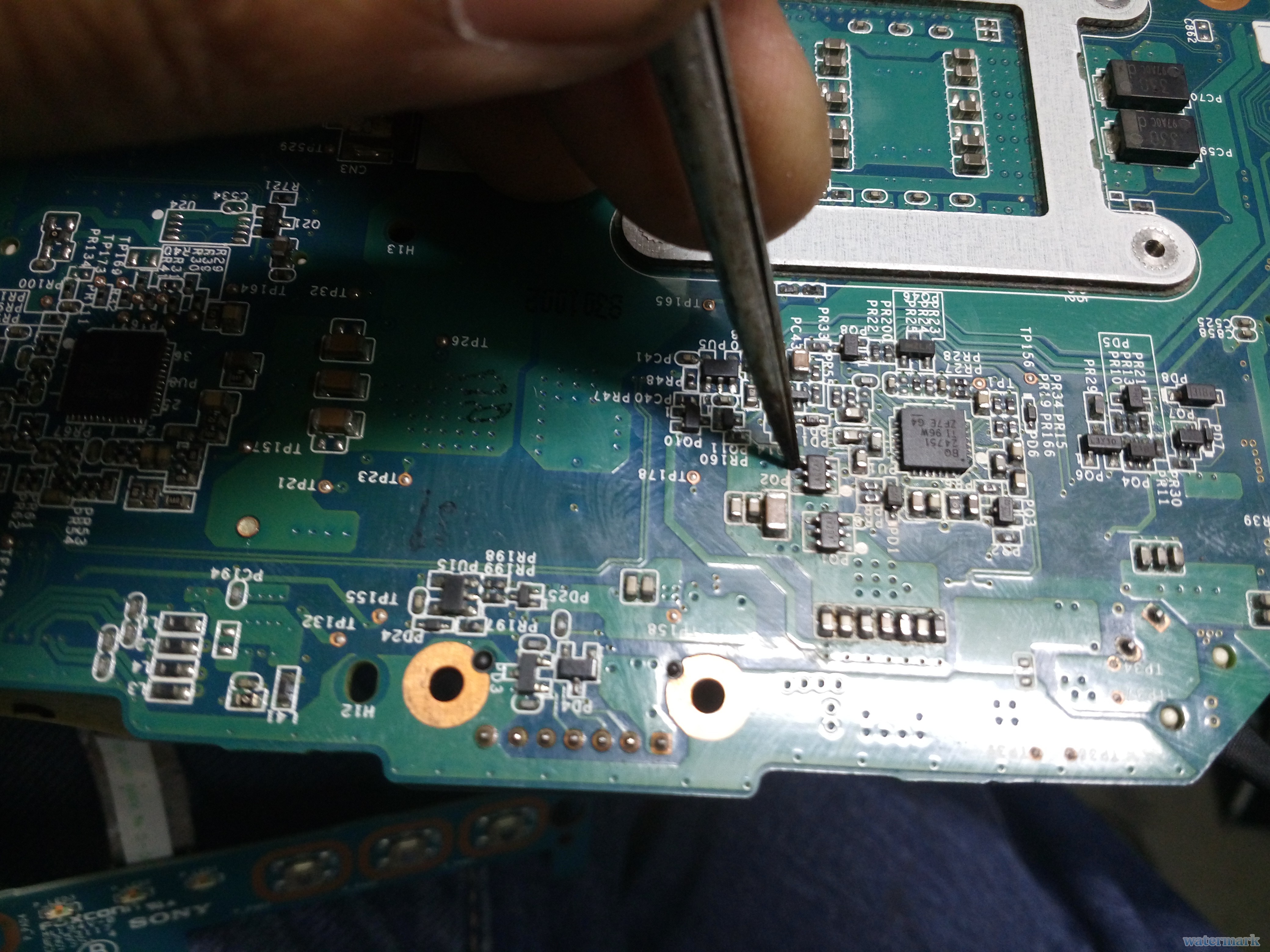

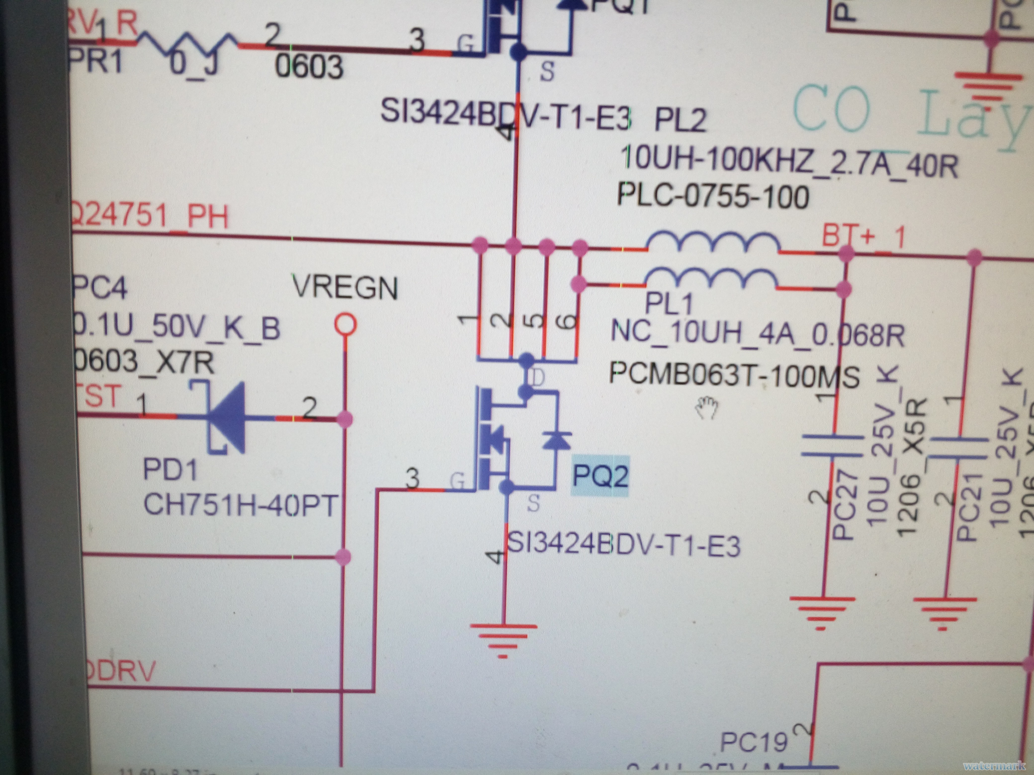

LAPTOP WAS DEAD 19VOLT WAS MISSING MOSFET PQ24 (SEE IN IMAGE) WAS NOT BYPASSING 19 VOLT
FIND PQ2(SEE IN IMAGE) WAS SHORT...
,, REPLACED IT AND THE LAPTOPS IS NOW RUNNING FINE
