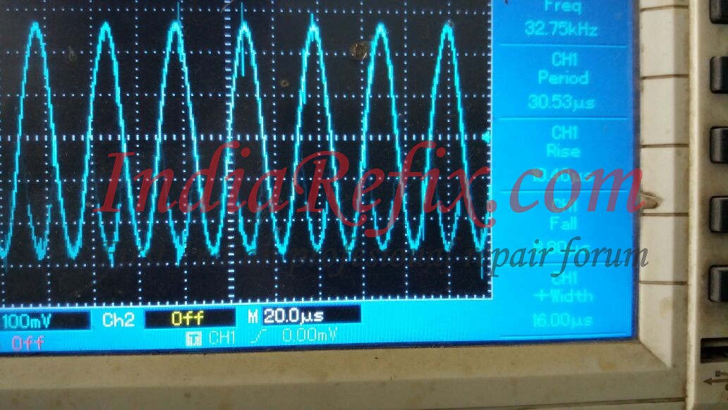

Rtc cristal x1 pin .
Pure sine wave of 32khz.

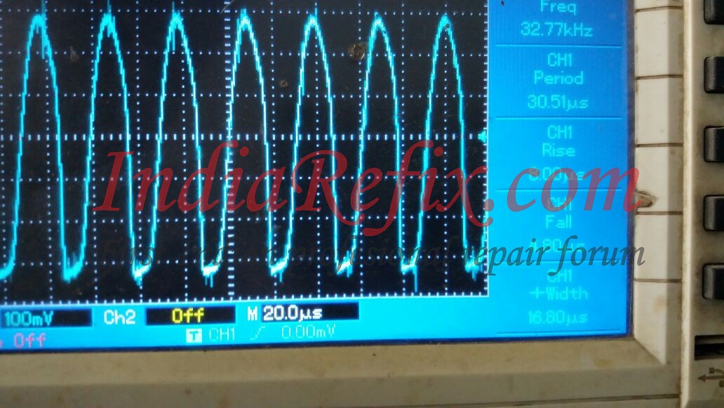

Out put of rtc section to the cristal pin x2 .
Same frequency of 32 khz but diffrence is amplitude . Little high amplitude due to amplification .

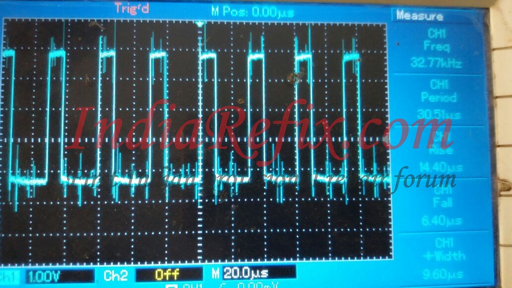

Sus_clk output of rtc section . After pressing pwr btn . Full swing squre wave of same 32khz .
