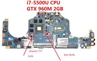

Thanks for the dump. I inserted a clean region replaced the Windows key. everything began to run very quickly. but alienfx doesn't work. On the motherboard there is still flash memory with a smaller volume. maybe you have a dump from it.
I think this is where the address is stored to manage Alienfx
