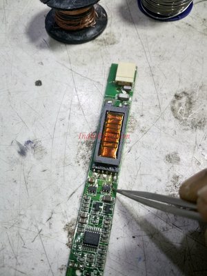

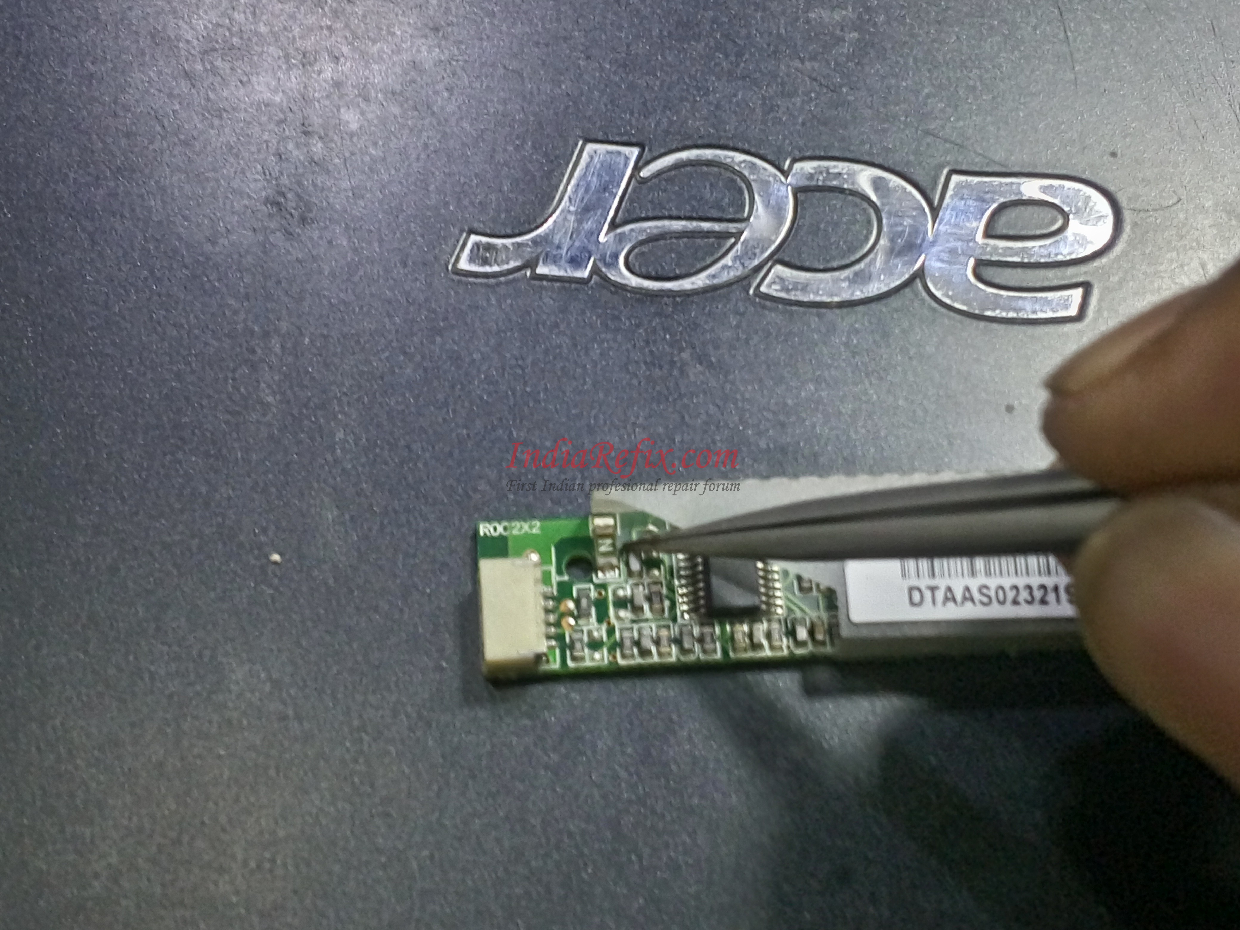

ACER ASPIRE 4720Z DIM DISPLAY
FUSE WAS CUT (PUT JUMPER ) AND ONE IC BURNED (CHANGED FROM SCARP FL)
