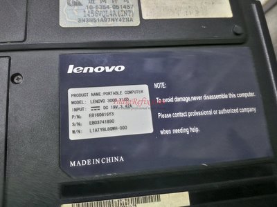

LENOVO 3000 Y100 DEAD
Posts: 50
Location: KOLKATA

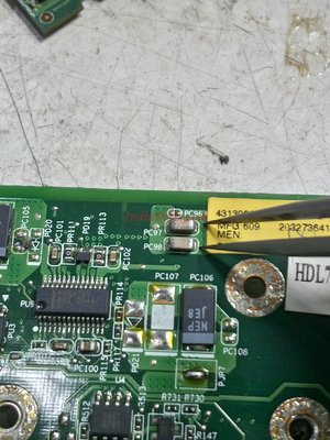

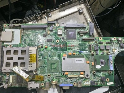

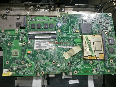

THE MOTHER BOARD WAS DEAD
NOT GETTING DC IN 19 VOLT
FOUND TWO CAPS SHORT
REPLACED AND ITS WORKING FINE
