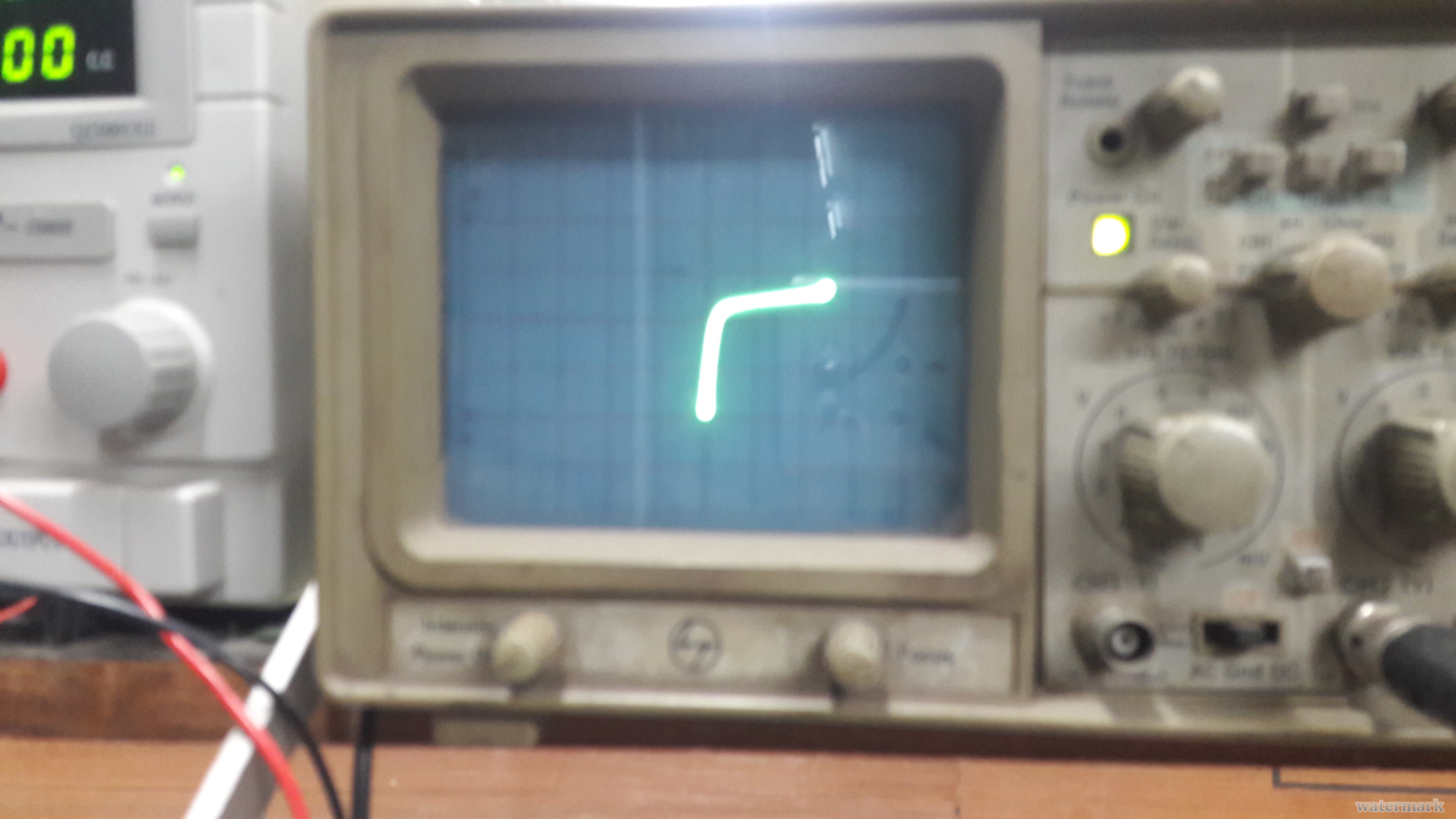

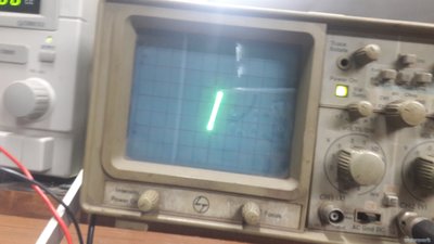

Finaly used CT functions to check vcore mosfet gate...One set of Vcore mosfet Gate was ...not Properly shown on CT...
Replace Vcore ic system start working
Bad ic Graph on CT

Good Ic Graph on CT
Good Ic Graph on CT
